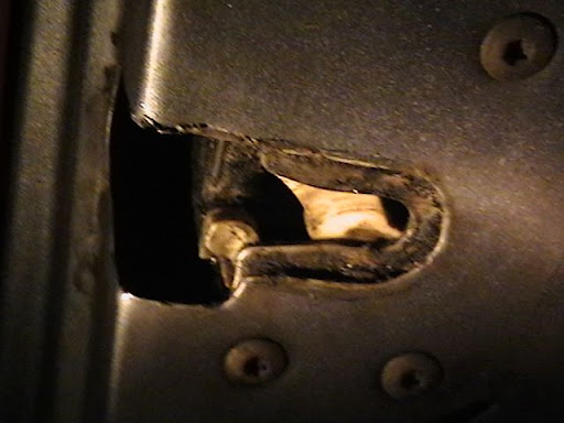

about a month or so a i replaced the pins and bushings($12) on the driver's side door and after i was done the back of my door was down about 2 inches. so i loosened the bottom hinge and adjusted till it would close. i have noticed lately that the passenger side door drops but the pins and bushings are not bad. the door was being pushed up by the post that hold the door closed. i adjusted both top and bottom hinges on the passenger side door to get it close to perect. i then adjusted the post that holds the door closed. you can lower it enough to make a difference. it help alot on the drivers side door. on the pasenger side door i removed some washers from behind the post. you can see the the metal rolling up from the door hiting the post.
