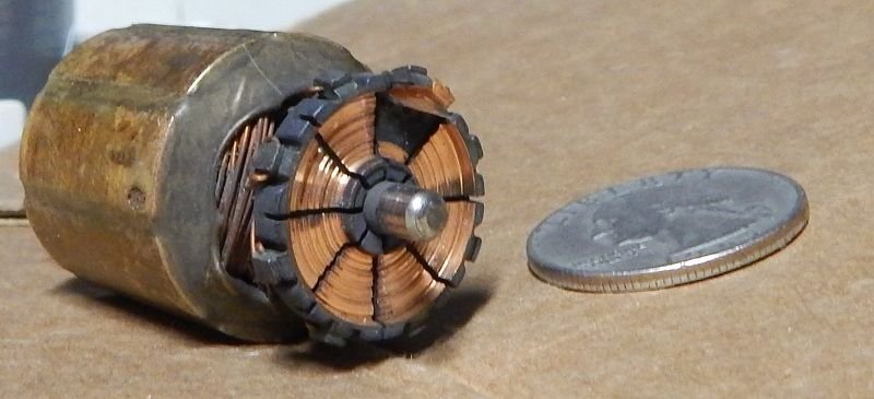

My 90 ram made it to 200 on the original pump but took a crap right after it. With my 96 i wasn't taking that chance and replaced it early(around 180k). This is what the pump motor commutator looked like.
As you can see it's paper thin and probably wouldn't have lasted to 200k. And the quarter is there to show perspective.
Well it's hard to judge by just miles alone. It really depends on how you drive. Whenever the engine is running so is the pump motor. Miles on a city only vehicle will be different than somebody that makes a hour trip to work everyday. It would be nice if there was an hour meter then you could really know when it's time.
