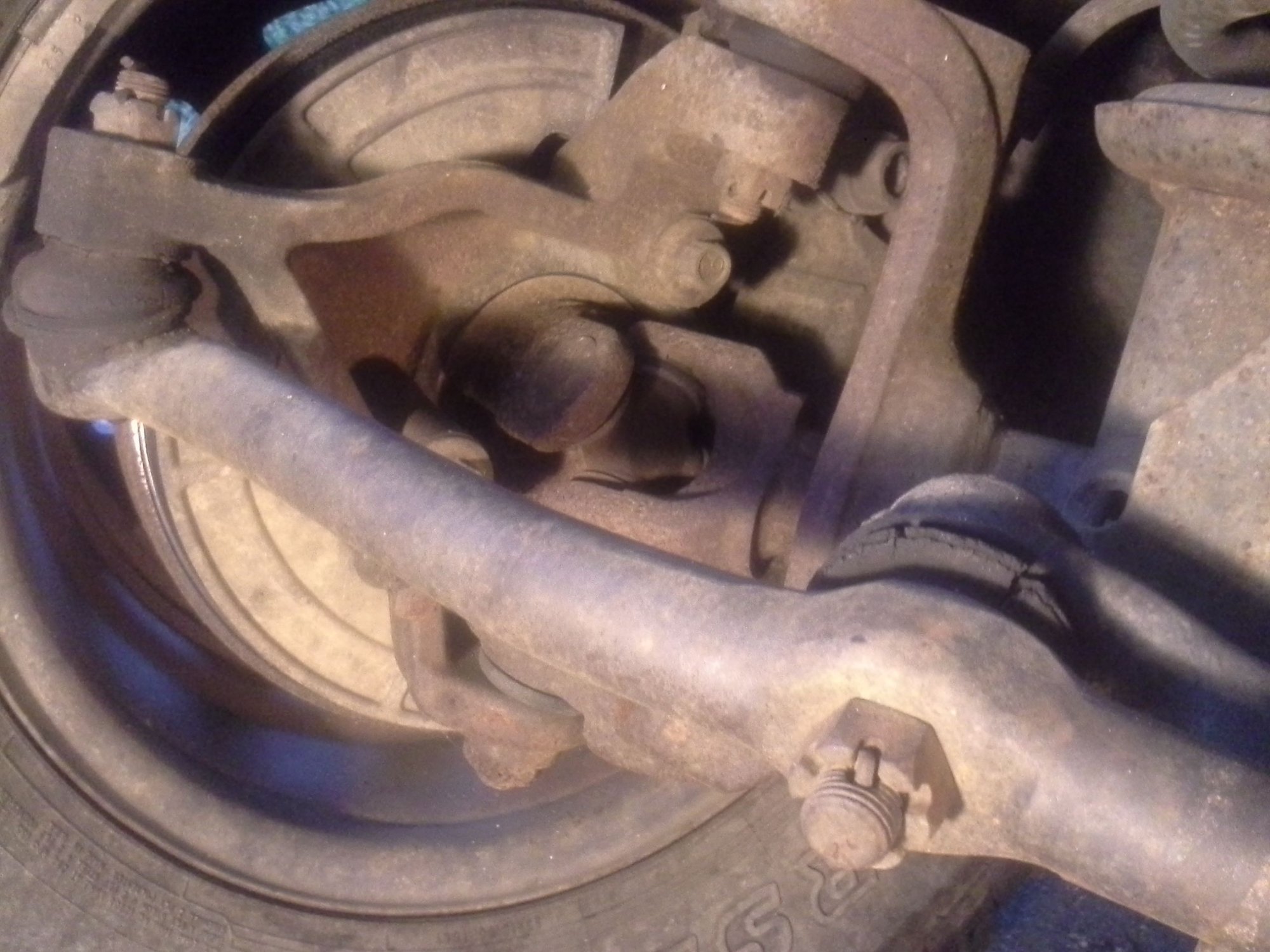

Did the full lock test. Left and right. Several times. Pass wheel was the worse. At 3 oclock 9 oclock, It wobbled some. Wasnt tight at all! And the ball joints were def dryrotted, No grease in the boots! Both lower ones had slits. Dried up in ball joint boots!
But also theres a bar going all the way across the truck, from the pass ball joint to the other side. It has a thing that looks like the part on a screen door that holds the door open. And another shorter bar leaves that bar at a "Y", about half way down.
When the wheels moved that little bit back and forth with hands at 3 and 9, that bar's moving a lot! Also all its bushings, boots are dryrotted too, like the balljoints boots. About like every piece of rubber under the front. And I can grab it and twist it almost 1/4 turn effortlessly.
Can that bar thing's bushings and rubber all be replaced? Or is that not a good idea? Like, should I just buy a new bar?
That ball joint's boot is open, has slits from dryrot, theres no grease in it. So is the other bushing to the right on the bar going to ball joint, so is that one up top on the part that 90's to the left. All dryrotted under the front and wheels wobble left to right, and that bar can be twisted by hand a 1/4 turn with ease. Is that normal? Also that u-joint slightly clinks back and forth a bit.

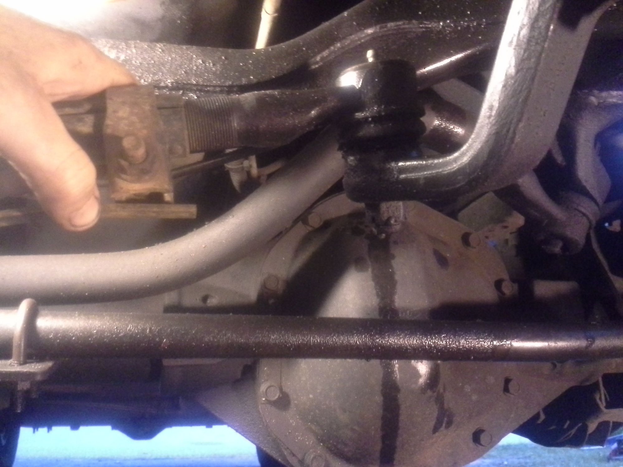

That fluid is from pwr steering hose leak! Another issue. But this is that bar that has that screen door looking piece.
You can twist it about a 1/4 turn effortlessly. It goes to the ball joints. Theyre both dryrotted and slits and no grease in them. Almost all the rubber boots and bushings are dryrotted under here! Think thats part of the prob?
Thanks for the help! I assume I need to replace those lower ball joints right away. The u-joint sort of clinks on the left wheel.

Looks like it's time to change out a bunch of your steering linkage. (that's the sloppy parts in your front axle.) Good time to do the HD upgrade? It's a crossover style steering, instead of the "Y" steering you have now.
The 'screen door' thingy is a steering stabilizer. It's basically just a shock absorber, mounted sideways.

The Y you're describing are the steering tie rods. They are definitely not supposed to move by hand. The sound you're describing is almost certainly that U-Joint that you found play in.
