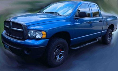

Hi Guys...First,Let me just say Thanks for all your help already..I have been searching and reading for over a month now on here and every other site...I just bought my 02 Ram QC 4.7 4x4 about 2 months ago...My very first Dodge anything...Truck was bone stock..Ive already done the 3" Magnaflow bolt on cat back exhaust,Magnaflow Y pipe,180 Tstat,E-fan,K&N drop in filter TMR delete and superchips 3865 tuner...Now Im stuck on either to do gears or 2800 stall converter...I really wanted the Stock HO cams but I can't find um and I just lost a set on ebay which went for over 500 and they needed to be refunished...I let the other guy have um...Oh well..Oh and I will be getting the bbk 70mm TB very soon...But like I said Im stuck on some 4.56 gears or the 2800 stall...Im running the factor 3.92's right now and I do a lot of highway driving...I use my truck as a truck (towing and 4 wheeling)..I did level it and put some new 17"s and 33"mud claws on it also..Im just trying to get the truck to go when I hit the gas!!!.Im not drag racing and all that..Just would like it to have some nuts!!!Like a truck should..Only reason Im even thinking about the new 2800 stall is because it says I will be able to tow in OverDrive..And also headers..I keep getting mixed reviews on if they even help or not...I would get the JBA shorties if I did get any....Anyway,Any advice on this would be awesome...And if Im messing up or not on any of these Mods.Thanks guys and IM so sorry for bouncing around a little!!Have a great day and thanks for reading

Thanks guys...Like I said Im not drag'n it or street racing,Just want more power so I don't have to floor it to pass someone or to get on the highway or even just to get it to move!!!As of now the truck has 140k miles on it and is very healthy I'd say..The tranny shifts like its new and even the tranny guy that did the service said its in great shape.Is their anywhere speacil I should buy the gears from?Id like to buy um in a kit that comes with everything I need!!4.56 seems to be the best gear for me..Im running 33's an might do 35's if I can get this thing running good...Also any input on headers?..Worth it or not?..Thankyou again
