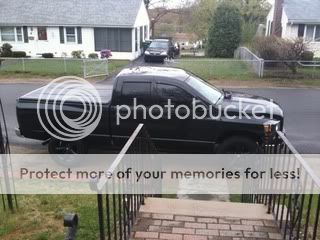

Hey guys i just bought a set of XD Wheels by KMC - XD797 Spy Black 20'' for my 05 2500 quad cab diesel and i dont know what kind and size tires to put on it. The website recommed 305/50-20 im not sure how big those are but i want it to look good tho. Anyone know if thats a good size and what kind of tire should i get? ill be towing 16000lbs 5th wheel on the weekends too if that makes a difference.
and if anyone has 305/50-20s can you post a pic so i can see what they look like
thats the wheel i just bought too.

Mine are Cooper Discoverer H/T. You have a pic of the truck?

I just liked the bigger wheels thats why i got them. i just want to find a tire that will look good on them and last a good bit.. would load range e be the best way to go with how much ill be towing?
and i paid $245 a wheel at http://customwheel.com/custom_wheels...ducts_id/23739

I'd say at least an E. That's a 10 ply tire. I'm not a tire guru, I just thought I'd mention it before you spend a buttload of money on tires that won't handle the wait. Just tell whoever you're buying them from what you're hauling, and they'll tell you what you can get.
Those wheels look sweet. Post some pics when you get them mounted. My truck had Moto Metal chrome wheels on it when I got, but I've been thinking hard about getting some black ones...
