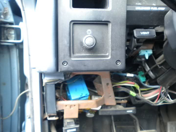

1) Take off the 2 lower dash panels under the steering wheel. 3 screws for the one directly under the steering wheel. And 2 screws for the one nearest to the drivers door.
2) Directly below the headlight switch under the dash you'll see a medium size "Blue" module. Now I've read that some of these modules have a 9v battery in them, which go bad after awhile and need to be replaced. In my case my truck DID NOT have a 9v battery in it.. Where the red arrow is pointing. thats where the 9v battery would be if your truck had one. Now if you look at the picture where the white circle is. Thats the button you need to press. Have the truck running, then use a toothpick or something similar and press the button.

3) Now reattach the panels, and your done, enjoy not having the light on to annoy you!
Now, all this info I gathered is from searching 4 diffirent sites, reading my owners manual, and by resetting the light myself on my '88 Dakota 2wd.
If anyone sees any wrong info. Please correct me. Thanx and enjoy!
