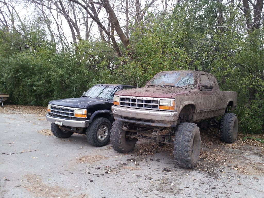

No way!! The only reason the 6.0s are dogs n crappy fuel is cause they were super leaned out from the factory.. U get em tuned even with em bone stock u gain way better economy n a lot more power.. I would cam it n do some other things right away including long tubed headers n such.. The mud truck would be unstoppable!!

Brian, this is my mud truck the only thing left that's stock is the engine and transmission.. I don't even have a stock tcase anymore.. So the engine n trans has to go I'm good with wiring, engine and trans mounts won't be an issue for me.. N thos trucks don't have pass keys n if they do all I have to do is get the PCM re programmed w out it.. And honestly I can't ever seeing my self ever selling it
