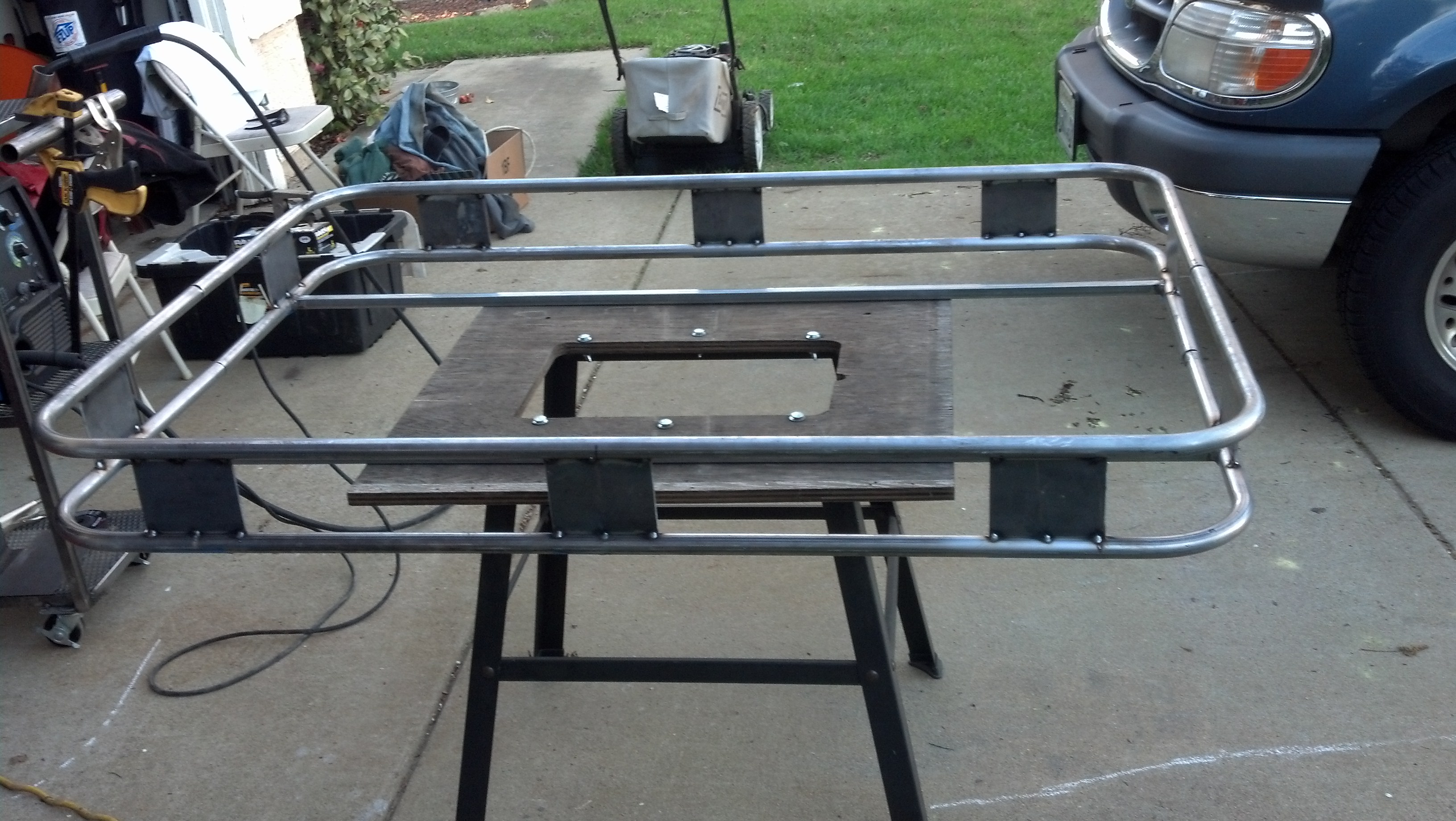

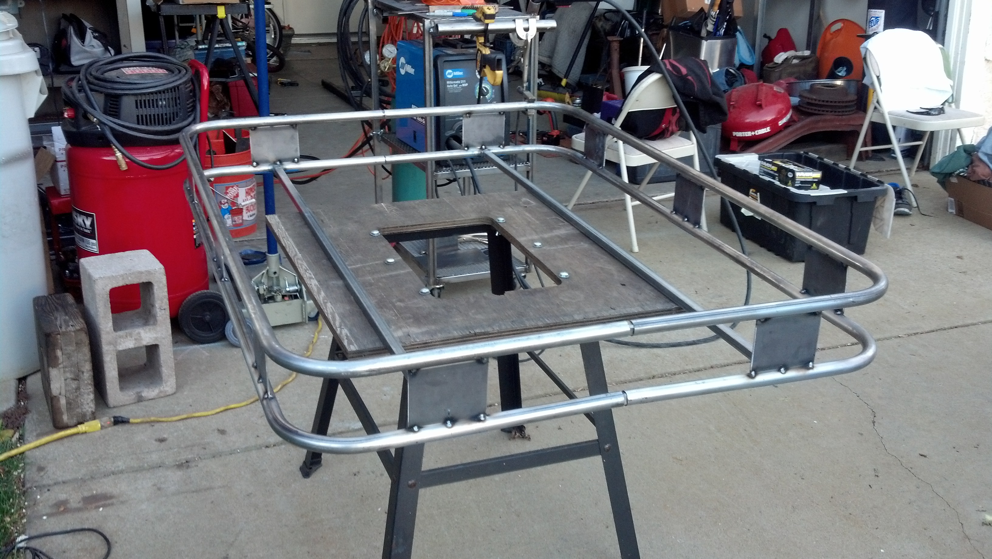

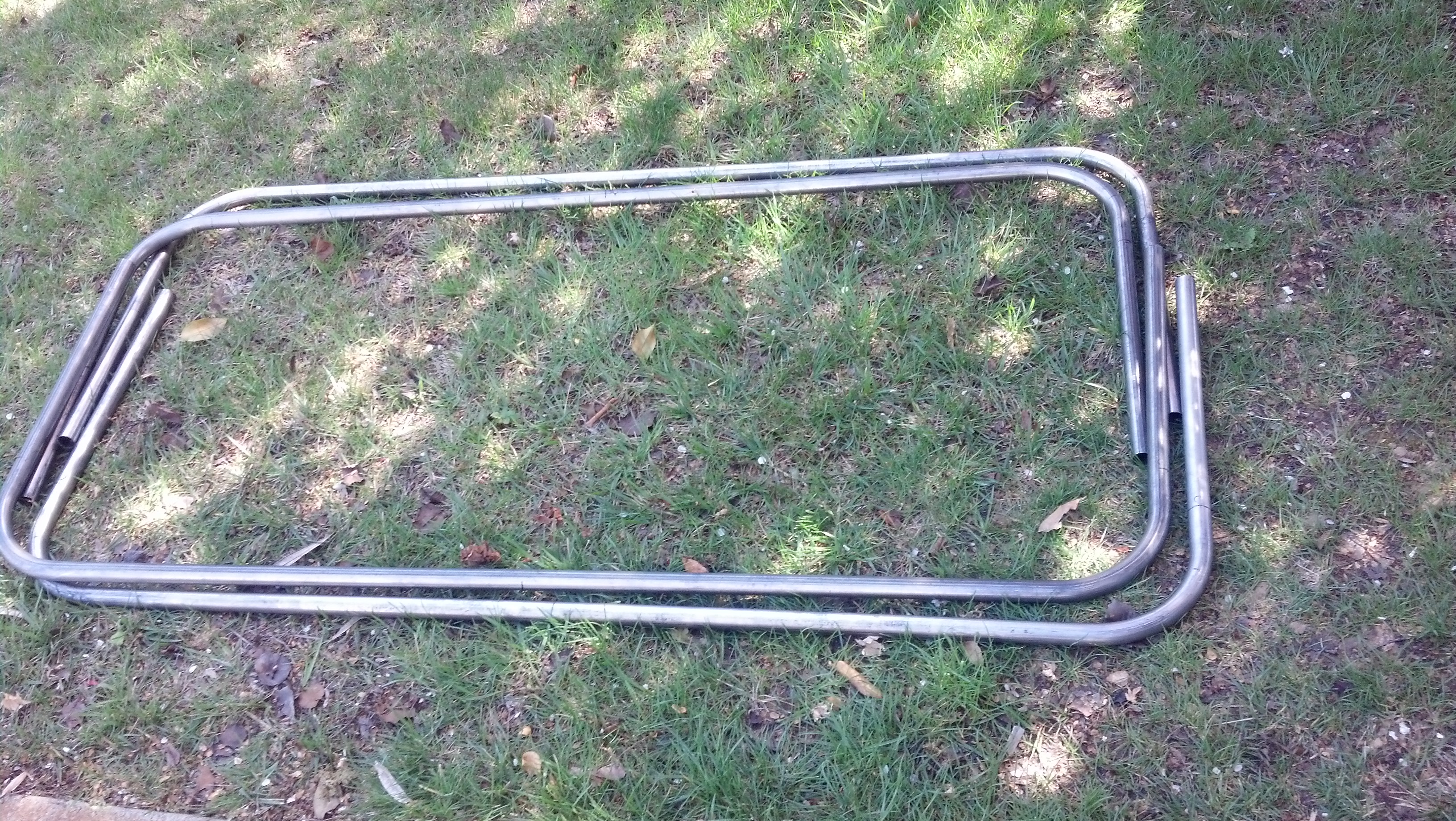

Here's a (sort of) build thread for a Durango. Unsure of what you are having in mind, but they take alot of work.
http://www.pirate4x4.com/forum/dodge...s-durango.html
Used my neighbors bender, he's been begging me for the last year to use it...so I started.
Last week's project done minus paint.

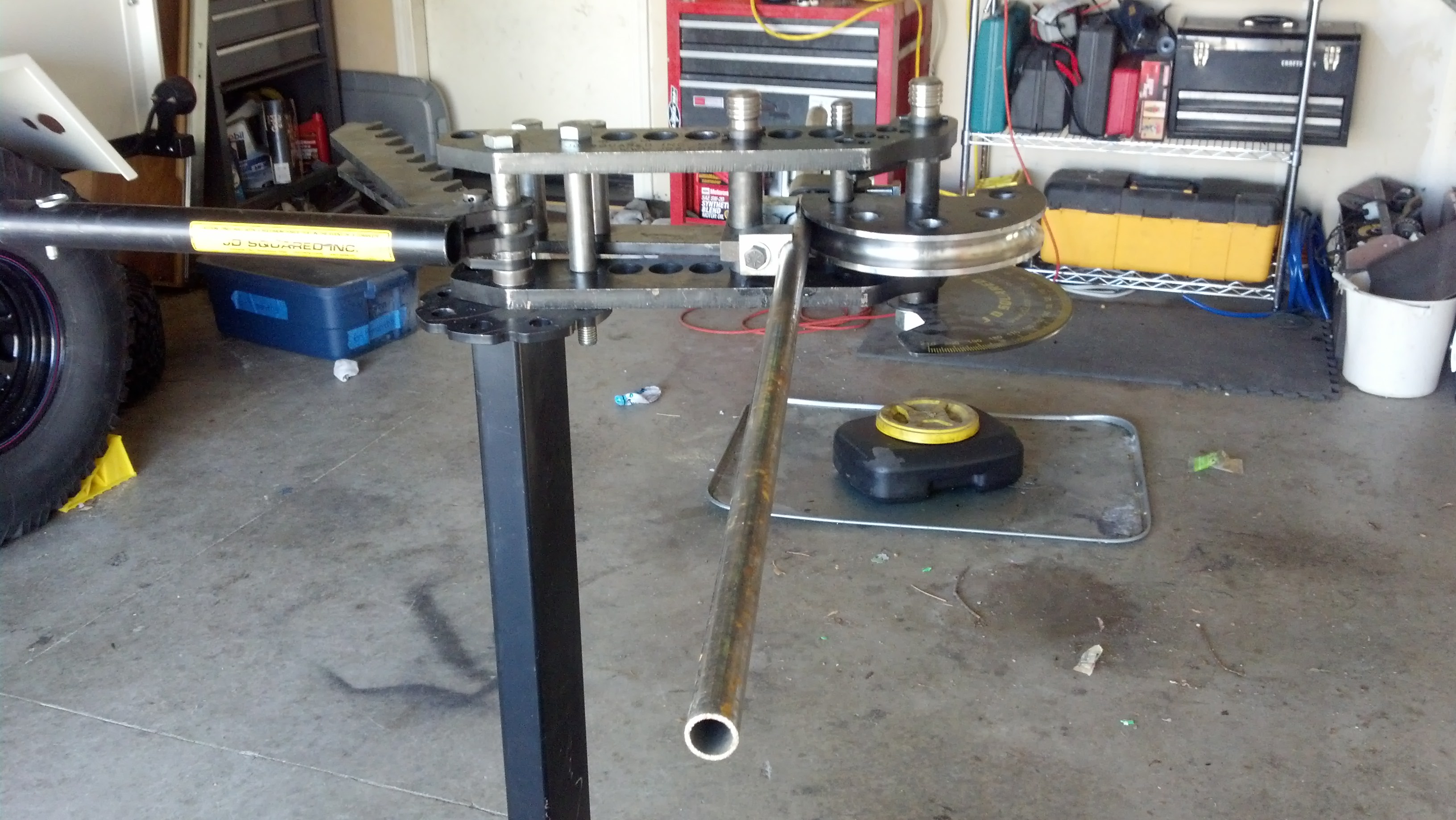

Mandrel Bender? How did you like that, and what size tube will it do?

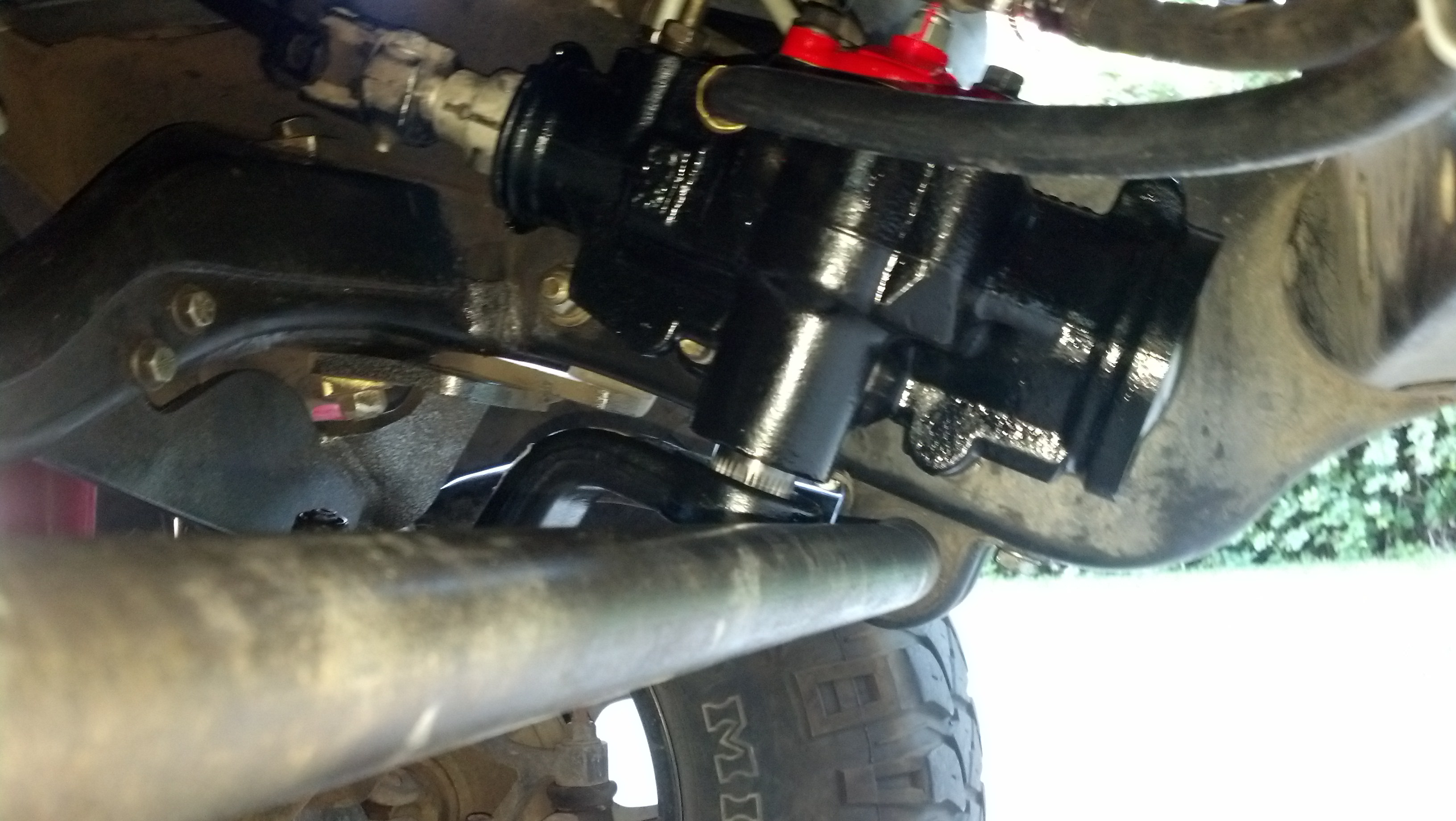

Originally Posted by Wh1t3NuKle
I'll find that older thread that compared Borgeson and Redhead to put this info in for people.
Link to that thread: https://dodgeforum.com/forum/2nd-gen...s-redhead.html
I didn't put in my own thread about installing the Redhead and additional cooler.
Did it back in August, so great solid 7 months. That includes DD on the old 35s, wheeling, and now with the 37s.
https://dodgeforum.com/forum/3069358-post12483.html
I guess you could call it mandrel, but not typically. The tube is clamped to the die. A follower is on the outside of the piece and the tube rides in the die. It's manually operated (can add hydro) to pull the piece around the die.
This is 1" tube 0.065" wall. JD32 bender
Here is where I'm at with it as of yesterday:
My favorite part is it bends the tubing without leaving that huge wrinkle on the inside of the bend. For doing exhaust and such, that would be awesome, IF it will do 2.5-3 inch pipe.

Wildman -- Give me dimensions, maybe it's sizeable enough to ship.....otherwise, see you tomorrow!
HeyYou -- the mandrel you are thinking of is at exhaust shop. Not an issue for that thin crap. This bender max OD size is 2.25" iirc. Each die set is like $200 - $400. Cheaper to go to a shop for your stuff.
