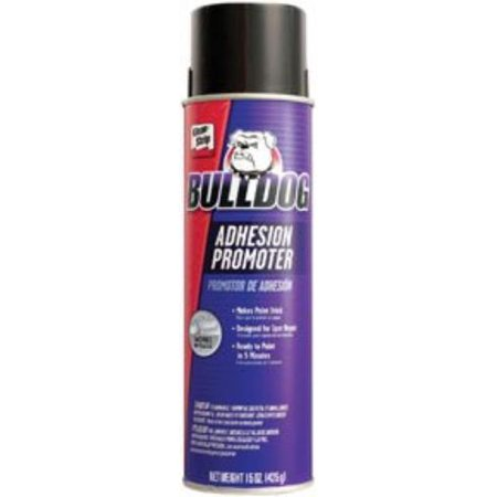

You could take off the knee bolster or glove box door and have a auto paint shop match it up for you. That is how I'd do it. Some of these places have the equipment to put it in a spray can for you, rather than rely on you spraying it with a spray gun. Also, would use an adhesion promoter so it doesn't peel later.

And yes use the adhesion promoter for sure.
