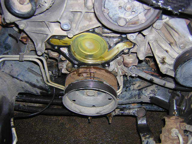

using Vin code is a good starting point, but you need to learn to tell the diifference by looking at them. if you get the wrong one, then you'll likely experience some PCM problems with fuel, and have to go back and screw around with the computer.
i "think" the difference is in the look of the harmonic balancer on the crank. somebody will correct me if i'm wrong. i'll post a pic of a 5.2 here in a moment.
VIN position ? Y=5.2 Z=5.9
