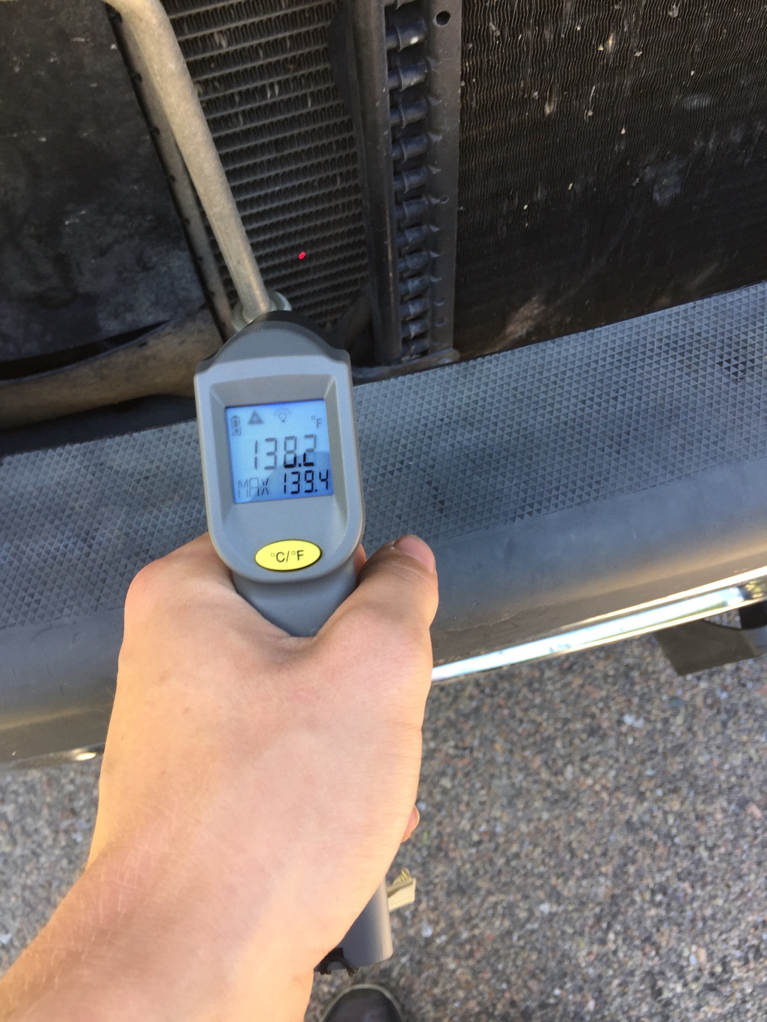

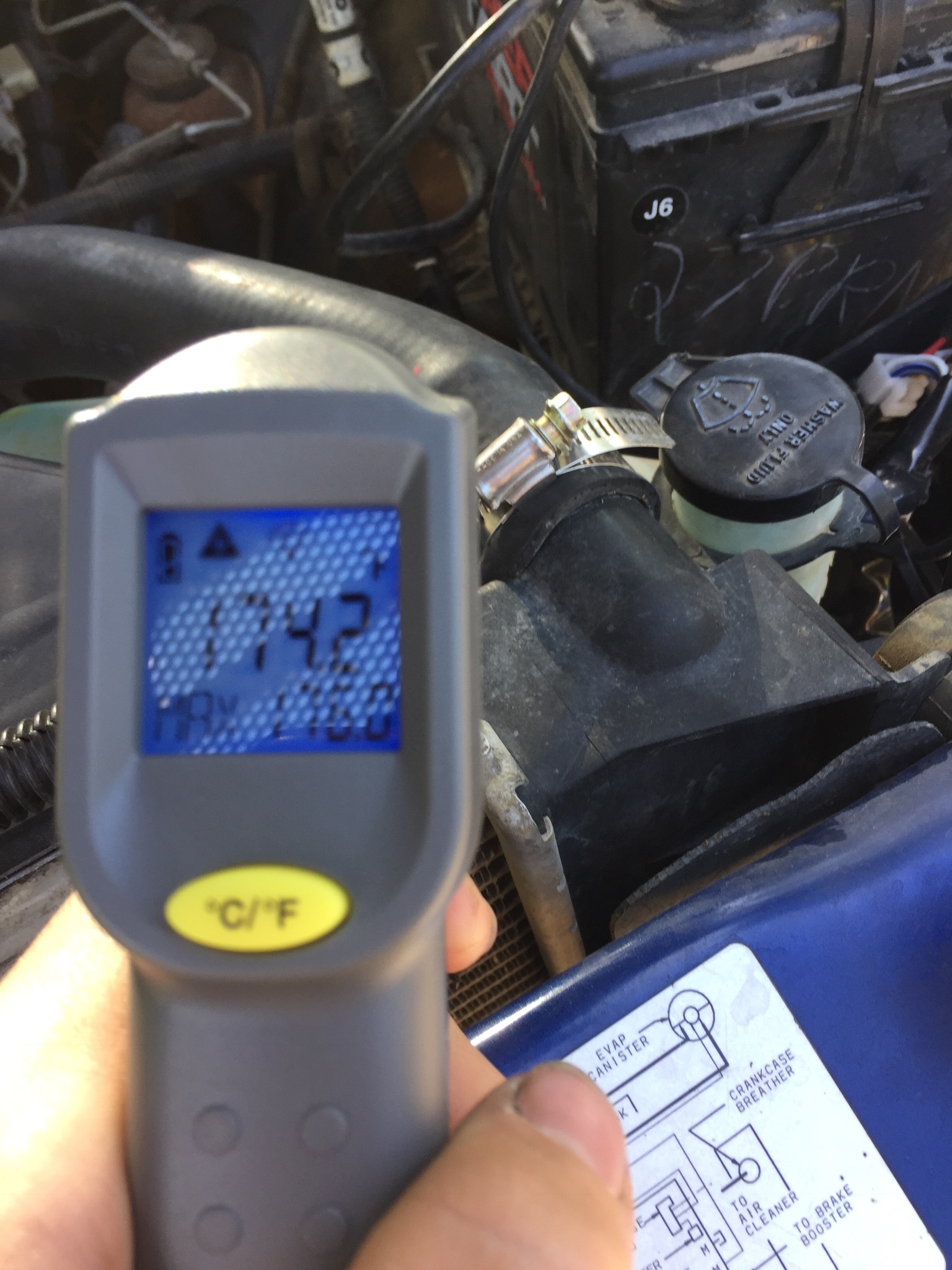

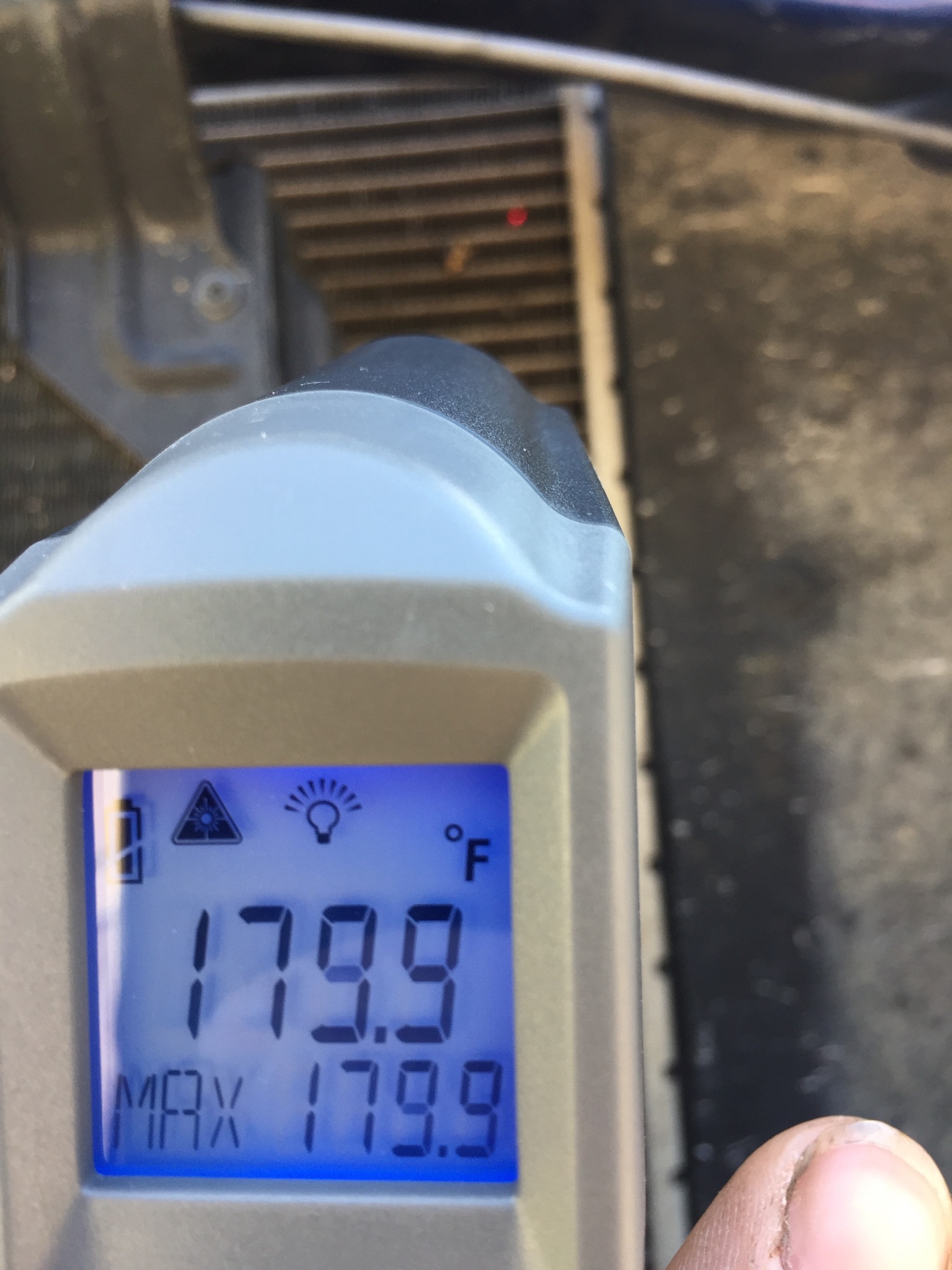

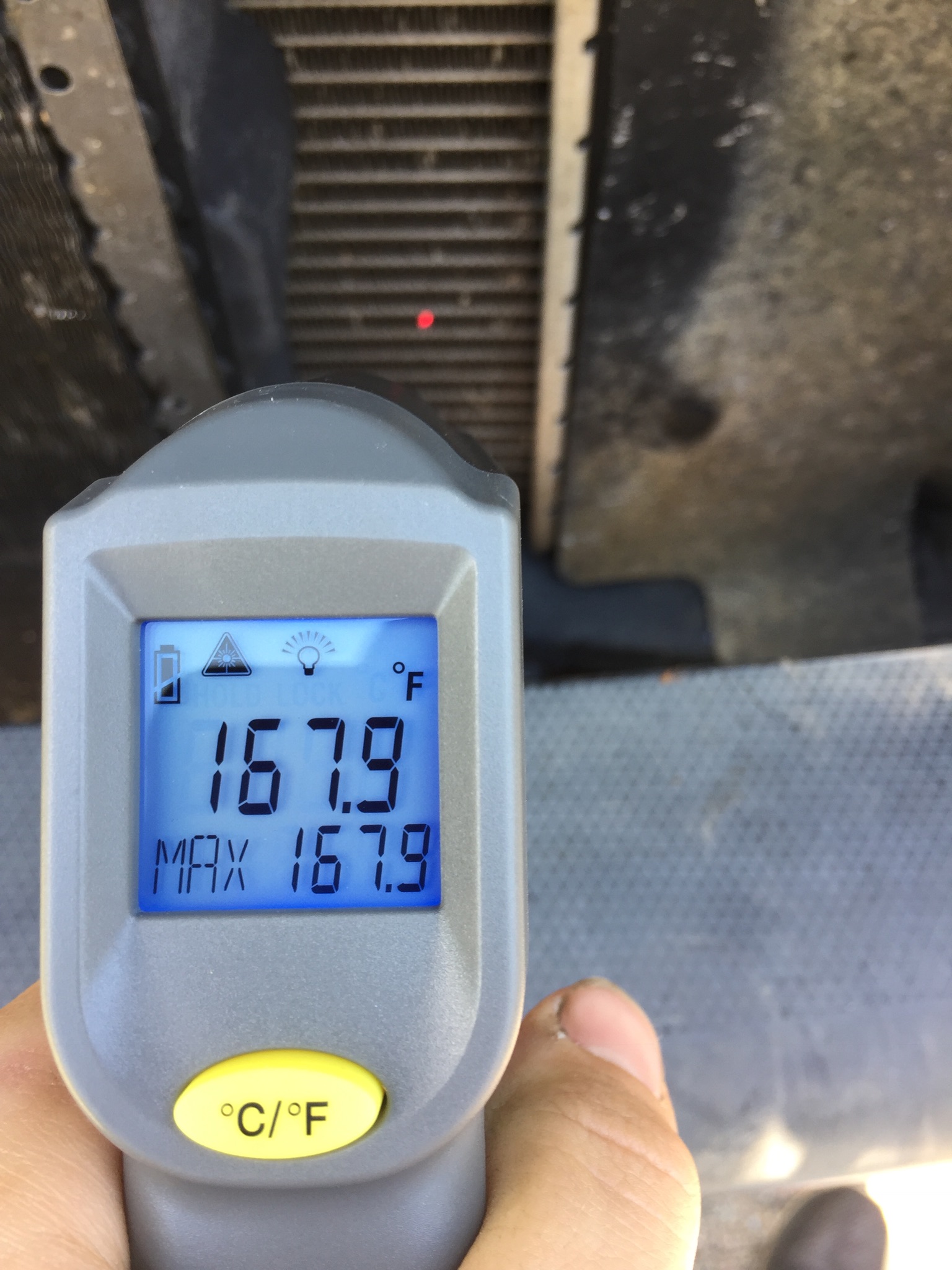

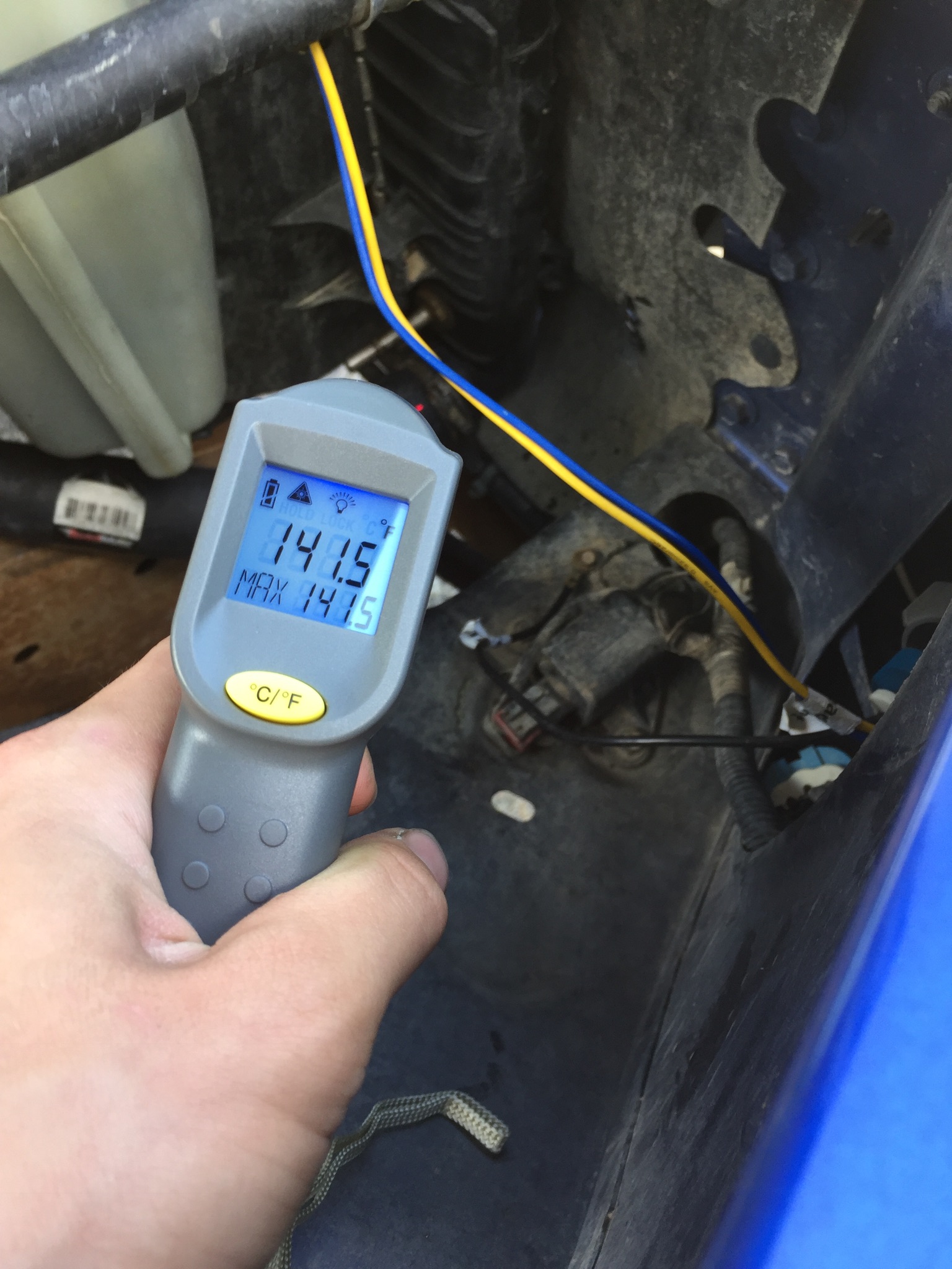

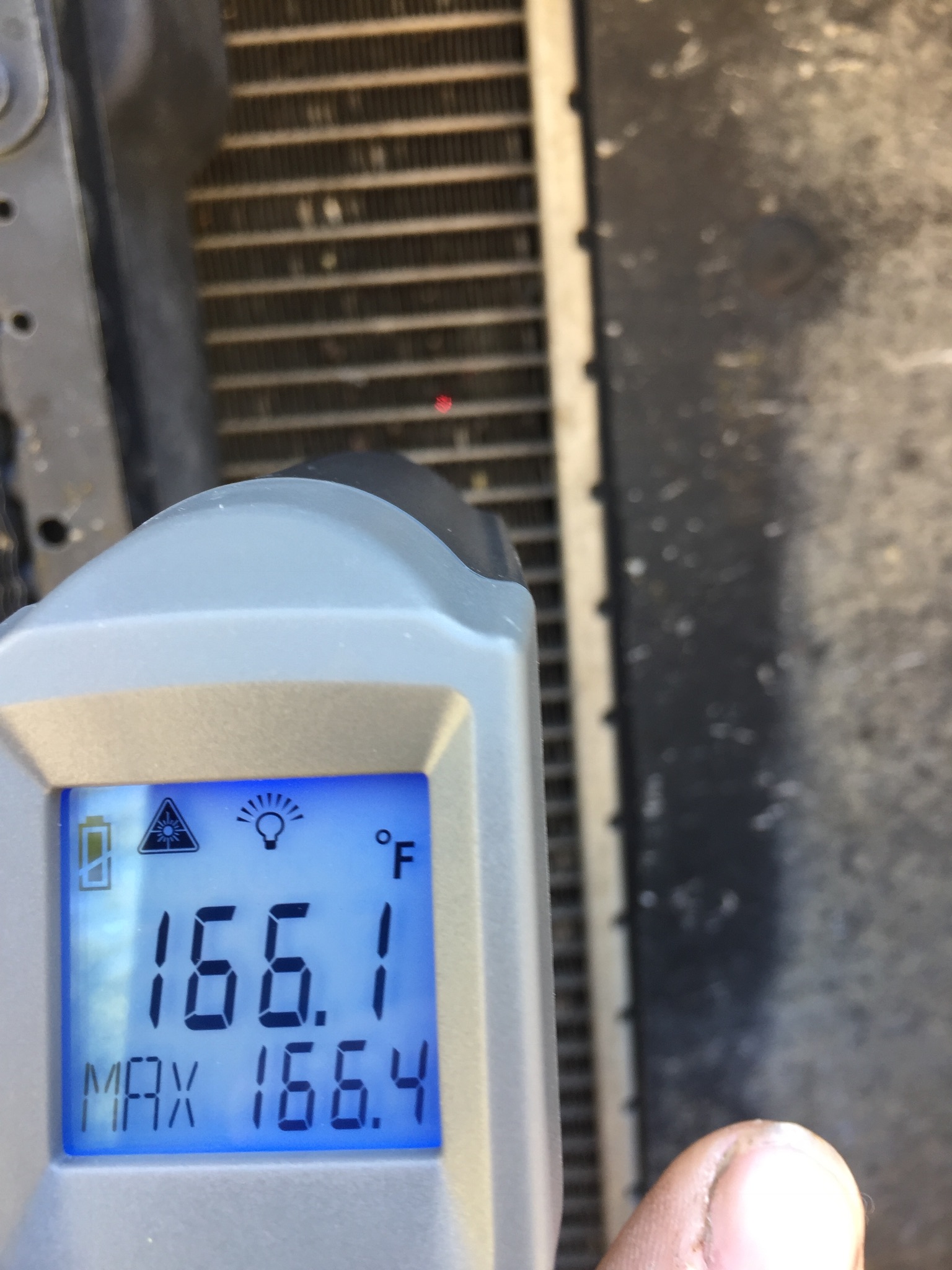

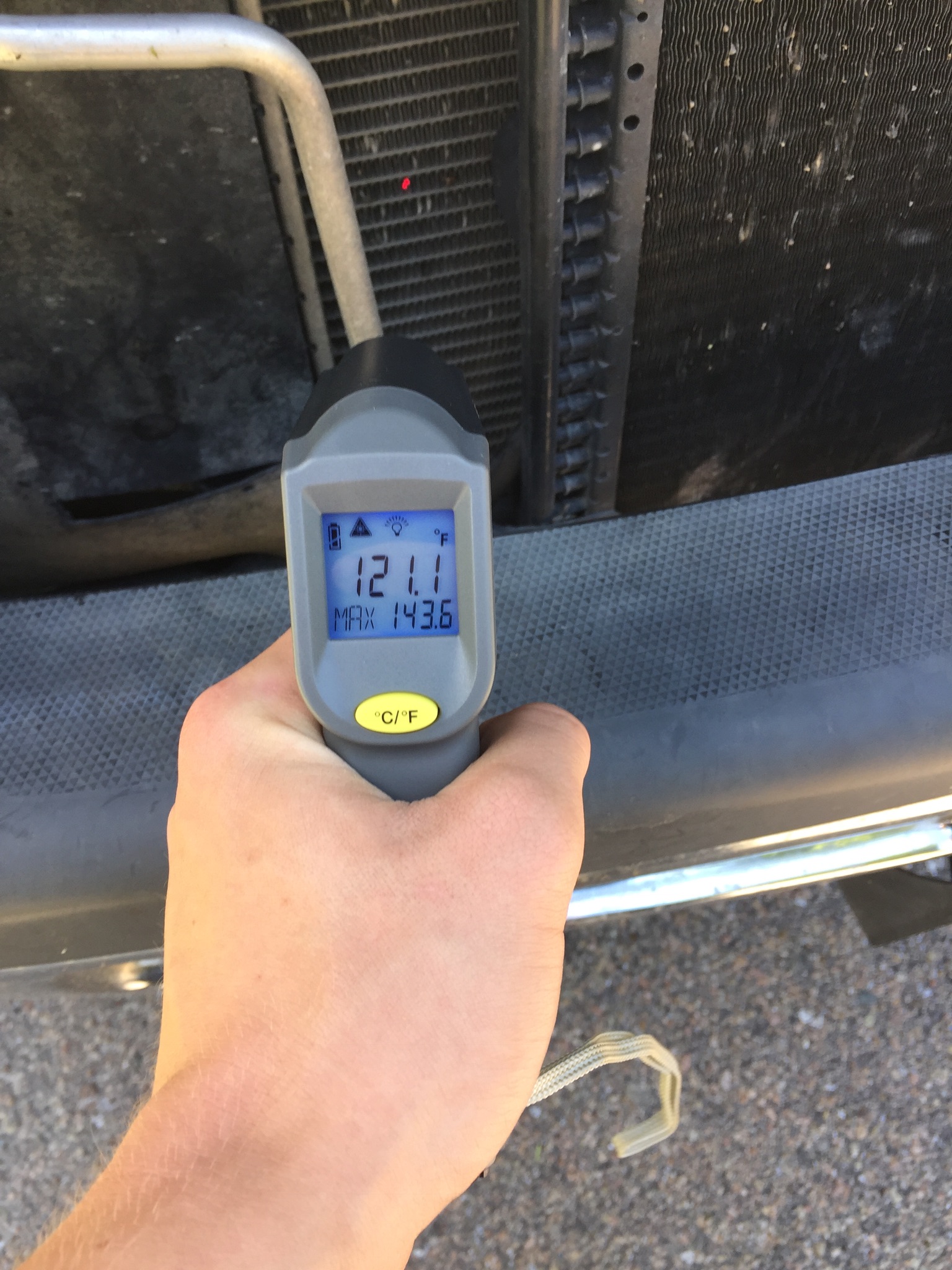

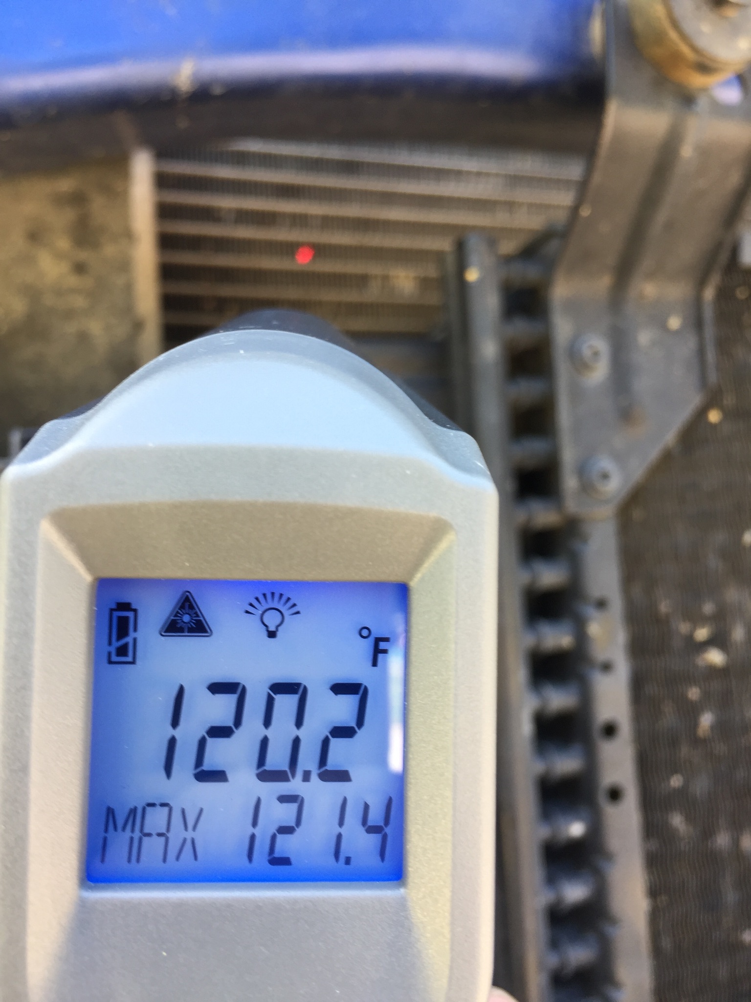

Well i got around to looking at it today, I can only really test what I can get the lazer in because of the ac condensar, but anyway, here are some pictures of the 2 sides.

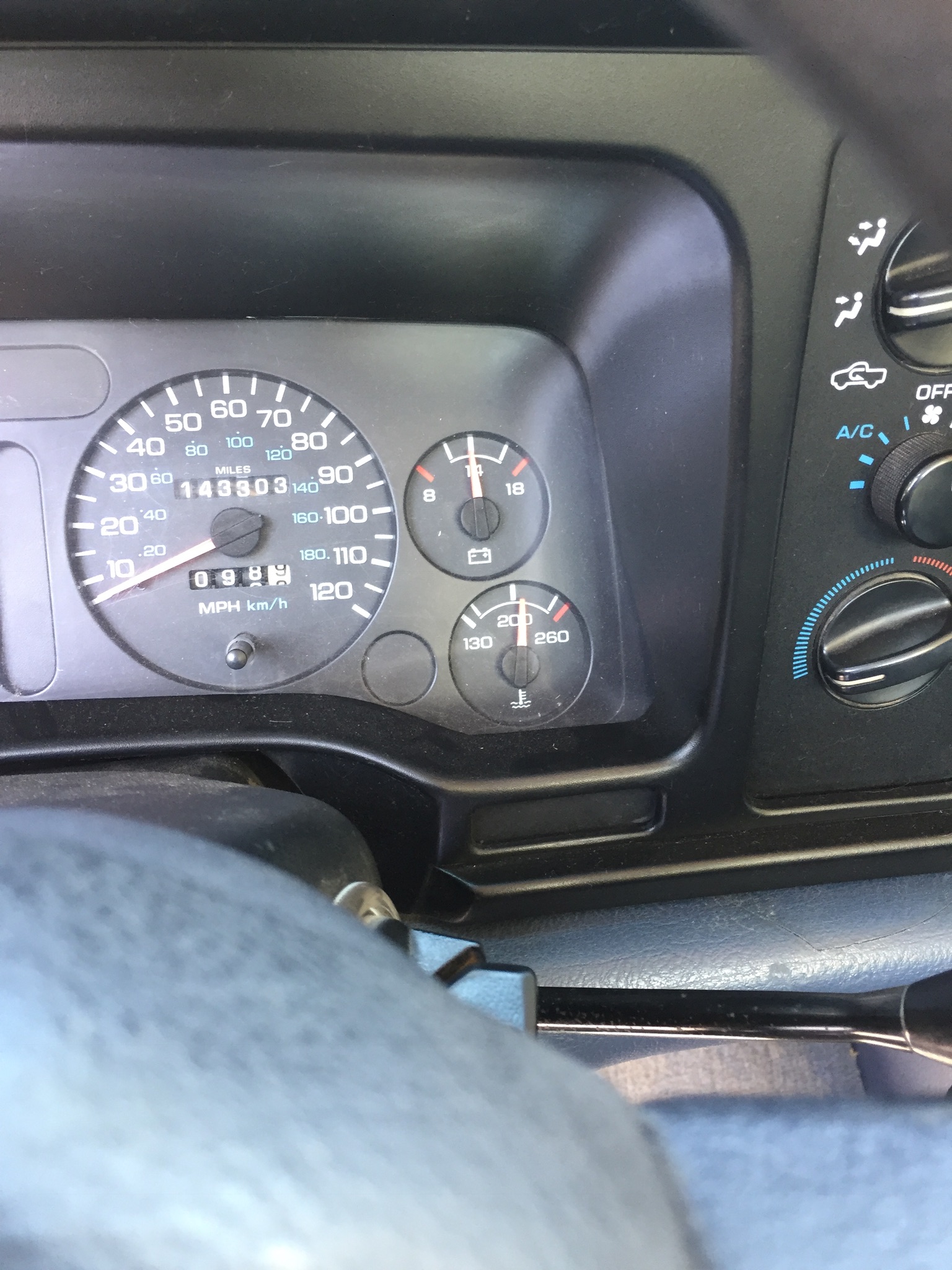

That's the temp when idling. It rises to about 230 on the highway.
It is also slightly warm on the radiator on the passenger side 1/4, or even 1/2, so I'm guessing this may be my problem, but I'm not sure. It's to the point where I can keep my hand on it and it won't burn. The drive side, will burn my hand though.
What do you guys think?
Old Jun 28, 2017 | 05:05 PM
Posts: 87,554
Likes: 4,230
Time for a new radiator.

Plug a scanner into it, and see what temp the PCM thinks the engine is. The gauge in the dash is not the most accurate thing in the world.... Even with a 195 degree stat in mine, the gauge always sat just a bit above 200.
