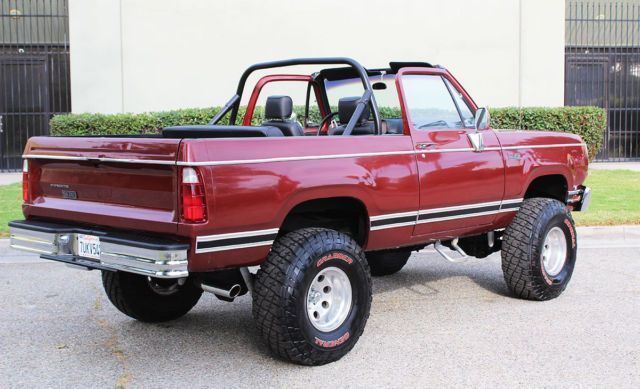

That was the exact same as the RamCharger just with Plymouth badging. They were awesome!
