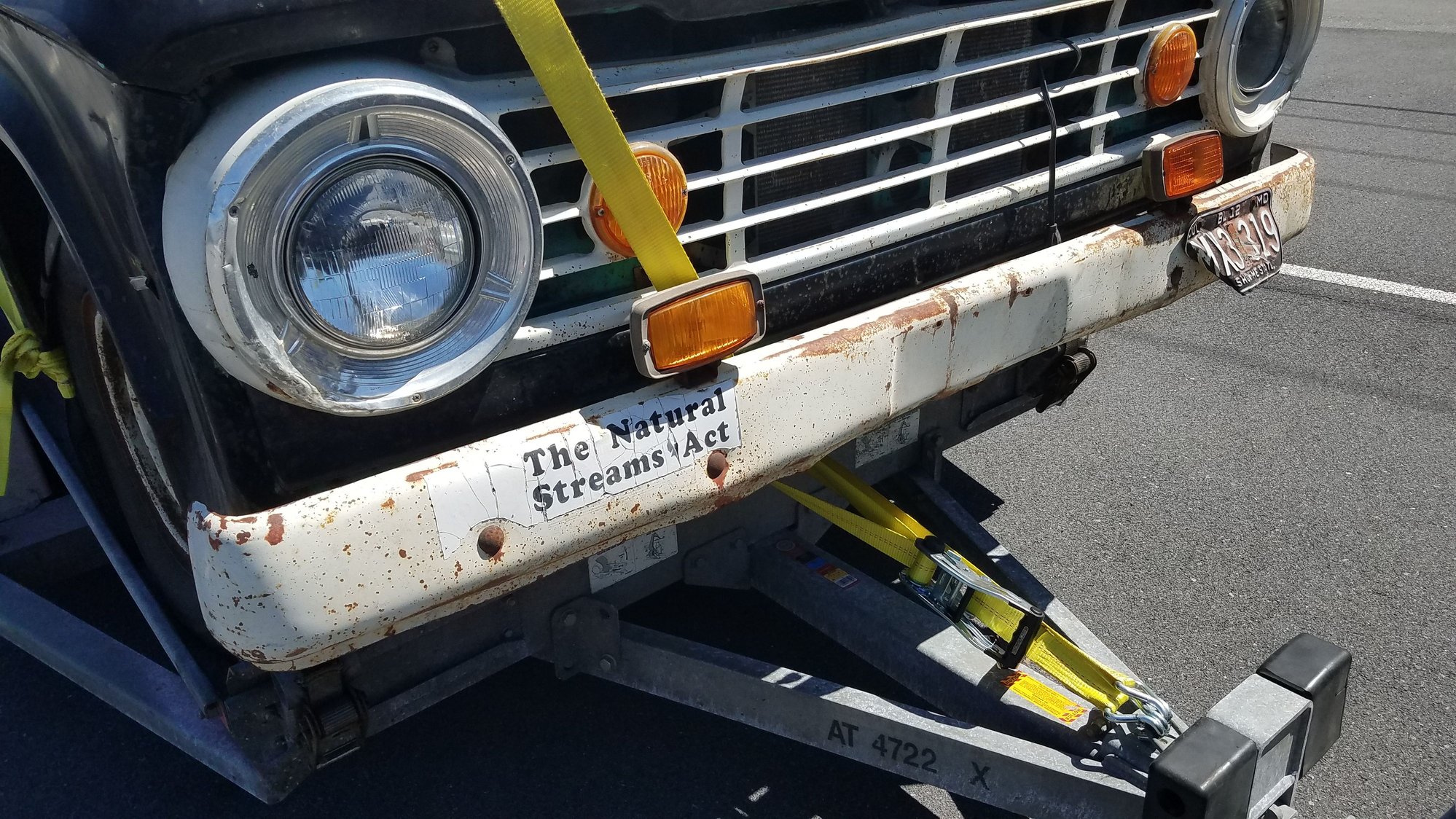

https://cimg6.ibsrv.net/gimg/dodgefo...120b6732e0.jpg
This is the 67 grill and bumper that are supposed to be on the truck. I plan on moving the entire front end over, fenders, hood and all

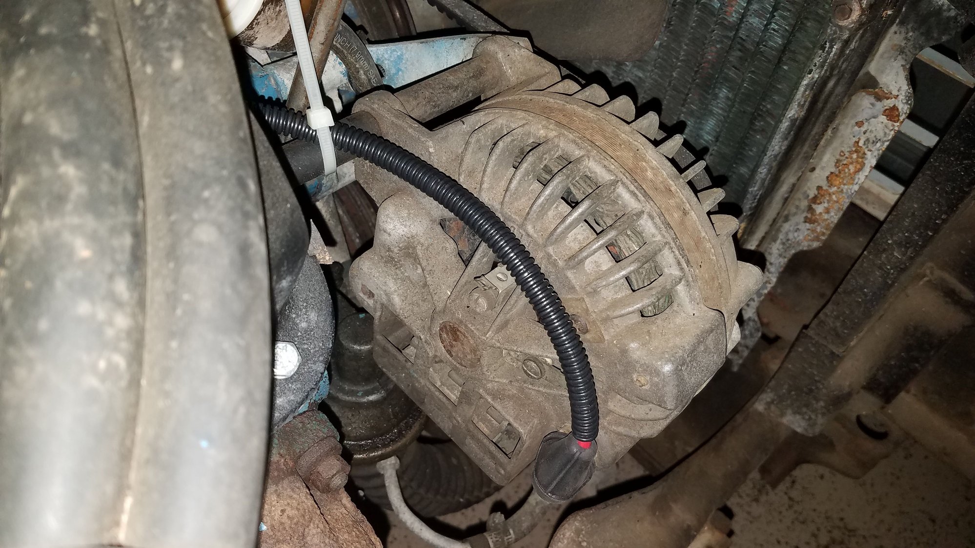

https://cimg2.ibsrv.net/gimg/dodgefo...d5fb993edd.jpg
This is the alternator in Isaacs truck. Is this internally or externally regulated?
https://cimg2.ibsrv.net/gimg/dodgefo...1370233fe5.jpg
Here is the back. It has the one large post, then two smaller ones. Anyone know anything about this alternator?

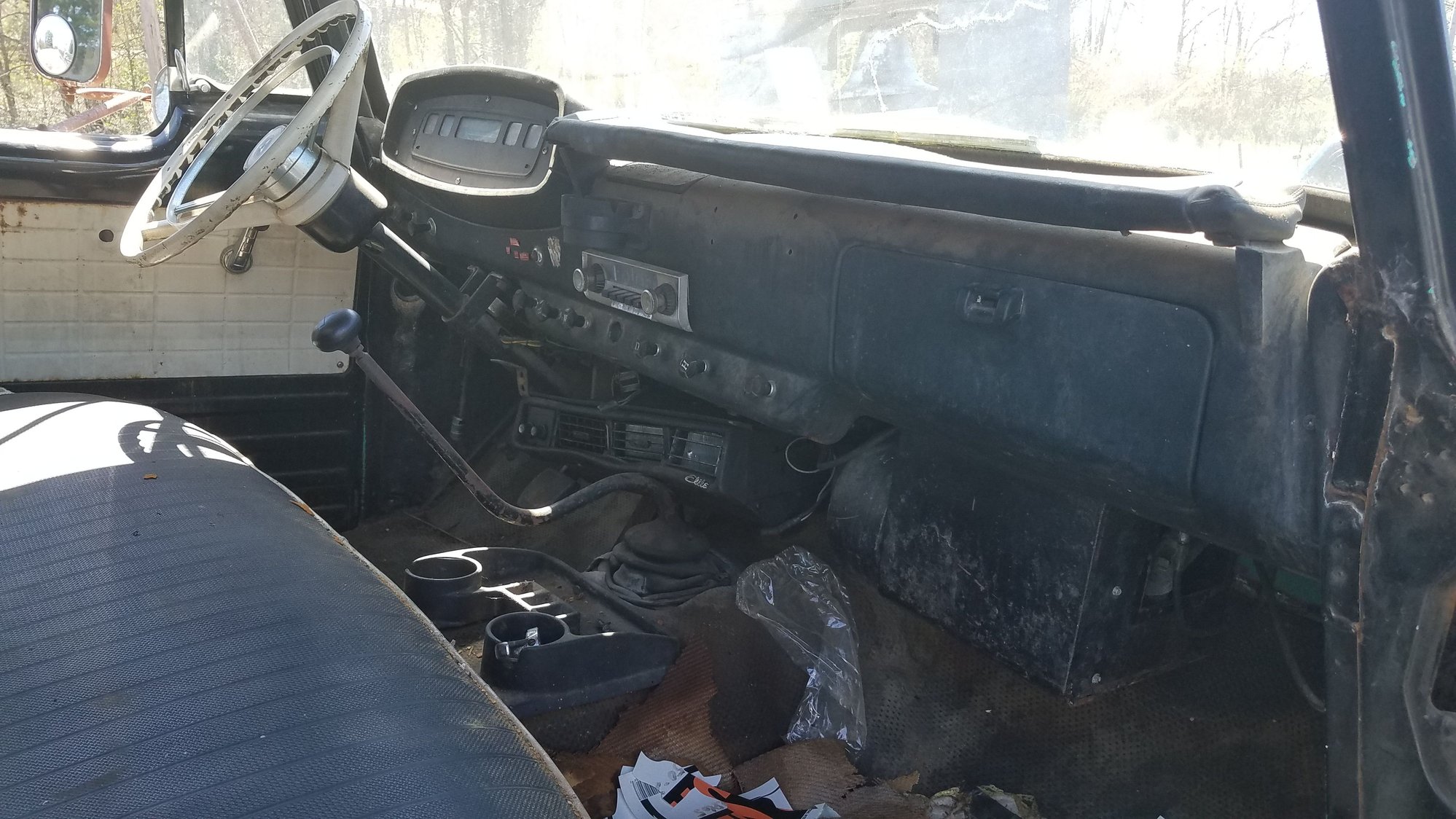

https://cimg7.ibsrv.net/gimg/dodgefo...0089514589.jpg
Got the old dash out. It had some issues, mainly a giant hole where someone used what appeared to be a chisel or an ax to install a radio.

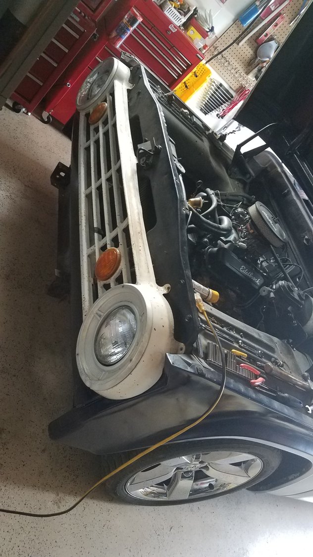

https://cimg3.ibsrv.net/gimg/dodgefo...2b2b1d3acb.jpg
Test fitting the 67 grill. I will have to swap the hood, and maybe the radiator support. Ill have to look. Im prepared to swap the whole front end. I like it.
HeyYou 04-30-2018 08:10 AM
The other two wires on the alt should be for the field windings, so yes, externally regulated. Should be a module on the firewall/fender somewhere.
Moparite 05-05-2018 09:10 AM
All mopar alternators are externally regulated. That's the "newer" version that was used on 72's on up. More info that you plan on reading here.

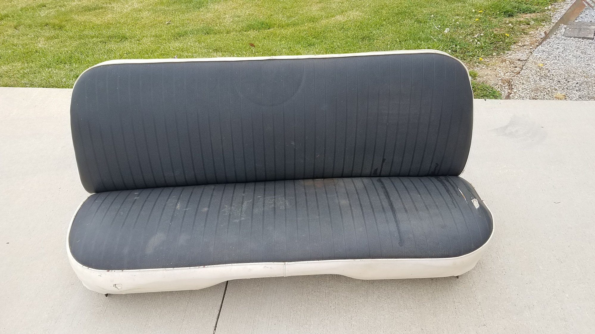

https://cimg2.ibsrv.net/gimg/dodgefo...6be31d11a9.jpg
The old seat. Im not sure if its original, but it looks old. It appears to be in great condition, other than a few rips.
https://cimg0.ibsrv.net/gimg/dodgefo...c2cfe3de39.jpg
Not too bad, after a little cleaning.

Got the dash out. It has some extrs holes, but they are small, nothing to worry about. The radio says Plymouth on it. The dash box had been soaked in oil, so it fell apart coming out. The pad is there, but drawn up. Ill have it recovered.
The door panels look good. I can clean them up. I wanted to use them, but looking at Isaacs truck, his inner door handles are a paddle type, and they swing out. The parts truck has handles and they turn around the center, like the window cranks. Ill dig into it more. The inner door panels on Isaacs truck are plastic, and they have been painted. They dont look too good. Id much rather use the panels from the parts truck.
