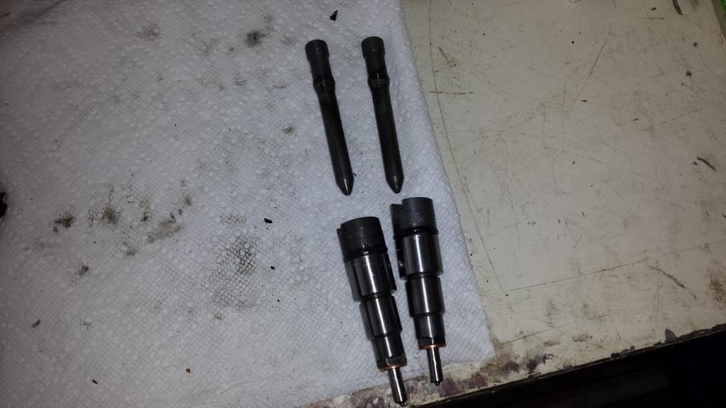

Taking ye ol rattle trap to the next level...
sneak peak of what is to be installed this weekend...
just might be joining the 600hp club...
Reply With Quote
Old 07-06-2013, 03:06 AM
Jigabop's Avatar
Jigabop
Jigabop is offline
Join Date: May 2012
Location: Renton, WA
Posts: 3,065
short descriptions of pics:
1 set of Crower springs for a Dodge Neon. They just happen to be the same size as cummins springs, and at cummins installed height will give 115-117# of valve seat pressure to help keep me from floating my valves with increased boost pressure (I will likely be pushing 75psi by the end of this build)
1 set of Manton Racing .095 wall 3/8" chromoly pushrods. (factory cummins length)
(had them custom made. They will handle the extra stress of the increased spring load no sweat where the stockers would be extra fatigued and have a high risk of bending)
and finally the power adder...
1 set of 6x.013 micro blind hole "SAC" injectors
custom built for me by Weston Shupe.
6 = hole count .013 = hole size.
micro blind hole sac = the nozzle style.
pop pressures are set to 300bar, spray angles are set at 152*
They should wake the twins up a bit...
I currently have DDP-150hp in there, and these if I had to guess at a HP number, it would be in the ball park of 220-250hp+ added over stock (they are capable of maxing out the injection pump if I push injector duration all the way)

Anyway, build is started!!
My help ran out on me early to go chase after poon, so I was stuck with very minimal help from the old man doing this alone...
Old man helped by informing me when the piston was at TDC and rockers were loose while I was under the truck with a ratchet and socket hand cranking the motor over.
so far I have the valve cover off (obviously), all 6 injectors and cross tubes pulled, and I have replaced the springs and push rods on #1 and #6 so far, as well as adjusted the valves after putting in the new springs and push rods.
Also took the opportunity to re-torque the head studs while I had the rockers off since I was already in there, figured it would be a good time to do so just for peace of mind.
here's a few pics I snapped...
sorry, not many pics yet as I was basically working alone without help, so constantly changing gloves just to snap a pic of a step is just wasting time and gloves.
Will get more pics tomorrow, and injector comparison pics tomorrow as well.

more pics for y'all..
install is complete, and truck is running nice and smooth. truck was powerful before, but now it's just ridiculously powerful
some install pics, and pics of old and new injectors...
and the pile of old parts that came out...

old 150hp injector next to new 6x.013 injector
closer view of new injectors nozzle
closer view of old injectors nozzle
even closer view!
last two injectors and connector tubes waiting to be installed...
again go to the cummins forum thread if you want more detail to the process lol.
got it done yesterday afternoon and got all of the valves adjusted and such. truck still hazes at idle, and damn it can lay out some smoke now! lol also quite a bit snappier.
