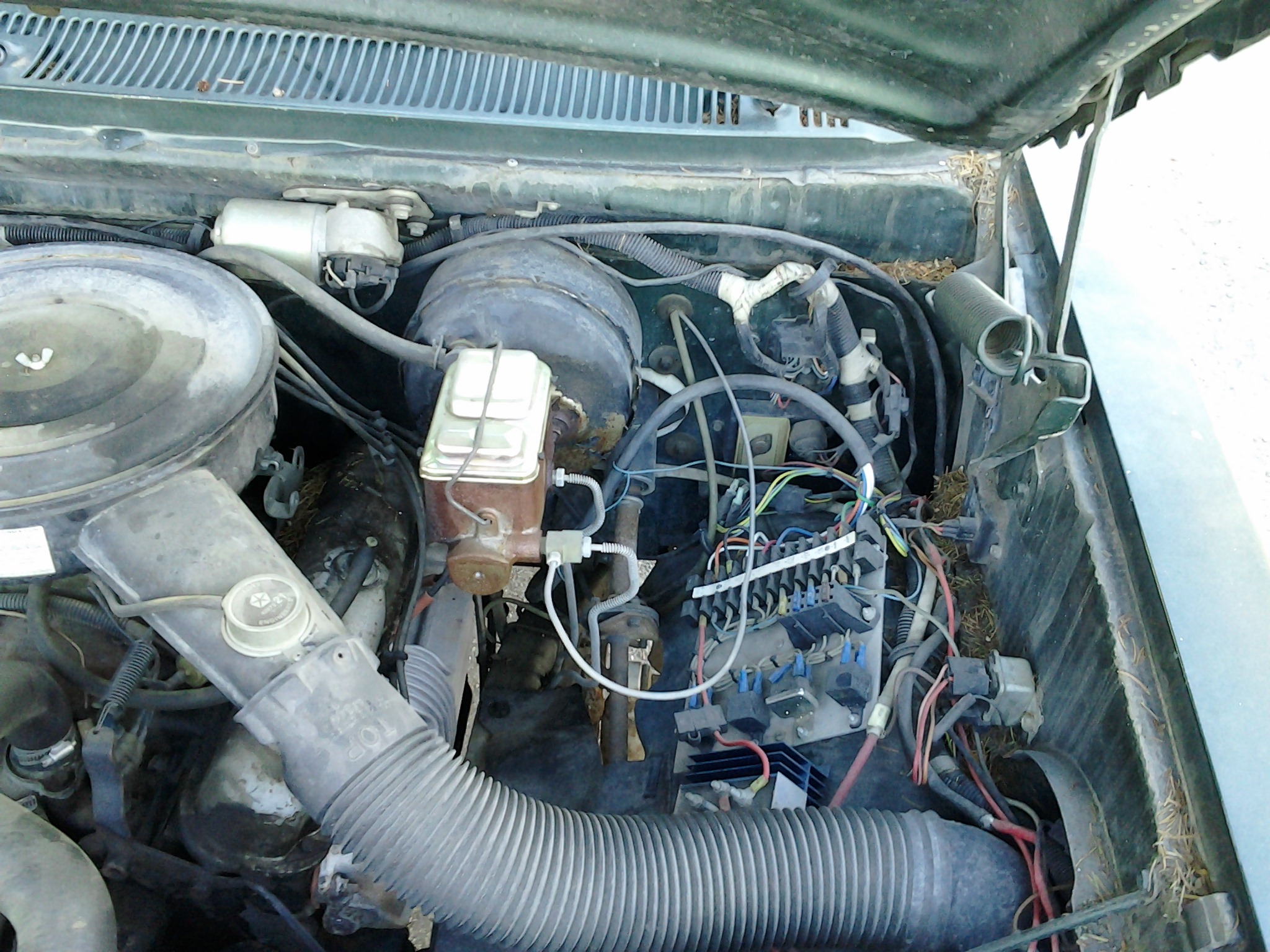

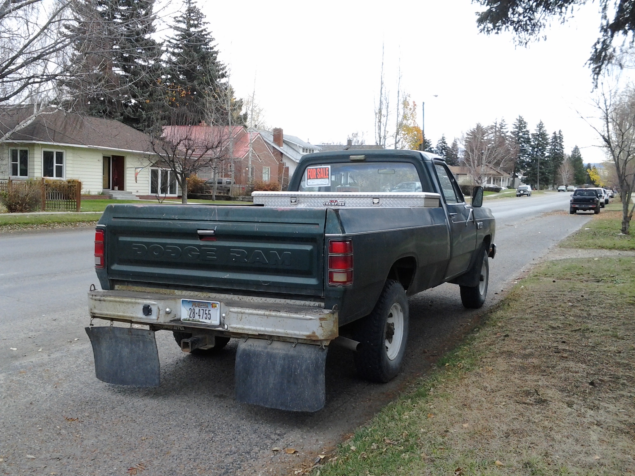

Hi All,
I just got a new, to me, 1985 W350 Prospector! I am super excited about it.
My wife took one look at it and said, "now I can get a tiny house!"...****.
A little about my rig, W350 so its a 1 ton, NP435 trans, NP208 transfer case, 31" tires, 4.11:1 gears, la 360 rebuilt/balanced/blueprinted 30,000 miles ago, has a standard tow hitch and a trailer light setup.
Now the question, can i safely tow 15-20k with this truck? Can i use the standard hitch or do i need to go to a 5th wheel? Do i need to add a leaf or overweight stop? Will i die in a horrible flaming death?
I was seriously considering the rear brake disc conversion, braided break lines, and upgraded rotors for better stopping. I think trailer brakes would be a must.
