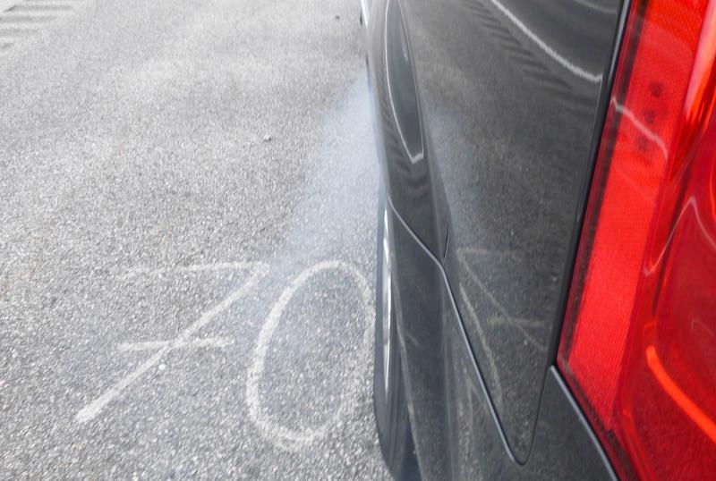

*updated* caliper slide kit
Hi
I think i have the sticky caliper problem... i go to my dealer in two days, i like to know if anyone have a reff number for a *updated* caliper slide kit for a Grand Caravan SXT Stow n Go P225/65R16...
yesterday on HW i got smoke getting out rear driver side wheel... i did a temperature reading of 425 degree celsius on the disk.... scarry!
I feel i got a real lemon there!
https://dodgeforum.com/forum/members...ake-19528.html
