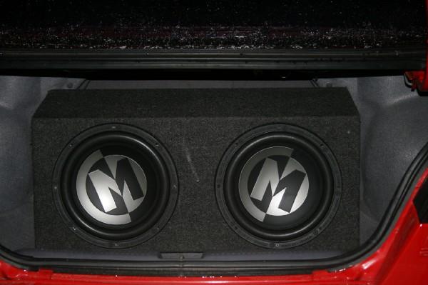

i have Memphis Car Audio Speakers & Subs in my car.... they sound greattt... the guy even showed me the difference between a few of the top brand speakers such as alpine and kenwood and imo sounded way clearer and just all around better sound quality than the others... for doors and rear plus installation ran me around $300.. as for the subs.. im running 2 12 " Memphis PR12 (Power Reference 12) they are no Competition sub but they shake just about everything in my car and im heard from a ways away lol.. (been pulled over twice for noise violation lol) im running a pretty small amp for what the subs need (TMA - Total Mobile Audio, 360 Watt. i was on a $500 budget so i couldnt get the bigger amp...)but trust me its still enough to give you chill bumps and shake the hell out of ur car.. when u got ppl in ur car they are def.. impressed... but again thats just my opinion.. what ever u like u can get but thats just my 2 cents... attached are pics of the subs & amp..
