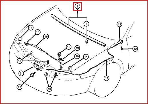

(#9) MB913064---WEATHERSTRIP, Rear (SAME AS ECLIPSE) (MSRP: MITSUBISHI---$10 / DODGE---DISCONTINUED)

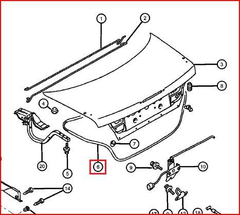

(#6) MB926017---WEATHERSTRIP (MSRP: DODGE---$86)

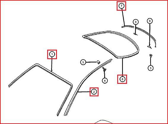

(#1) MB882471---MOLDING, Windshield (MSRP: DODGE---$66)
(#2) MB882473---MOLDING, Drip Rail, Left (MSRP: DODGE---$44)
(#2) MB882474---MOLDING, Drip Rail, Right (MSRP: DODGE---$44)
(#6) MB882472---MOLDING, Rear Window (MSPR: DODGE---$25)
(#7) MB882475---COVER, Rear Window Moulding (MSRP: DODGE---$43)

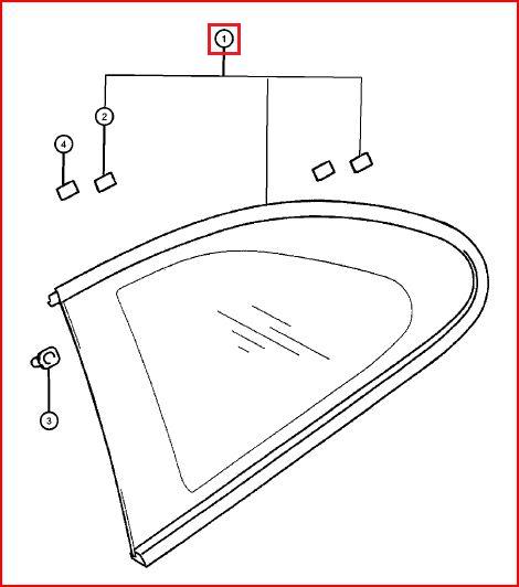

(#1) MB882465---GLASS, Quarter Window, Left (w/Moulding) (MSRP: DODGE---$91)
(#1) MB882466---GLASS, Quarter Window, Right (w/Moulding) (MSRP: DODGE---$91)
GLASS AVENGER:
(#1) MB882463---GLASS, Quarter Window Left (w/Moulding) (MSRP: DODGE---$193)
(#1) MB882464---GLASS, Quarter Window Right (w/Moulding) (MSRP: DODGE---$193)
