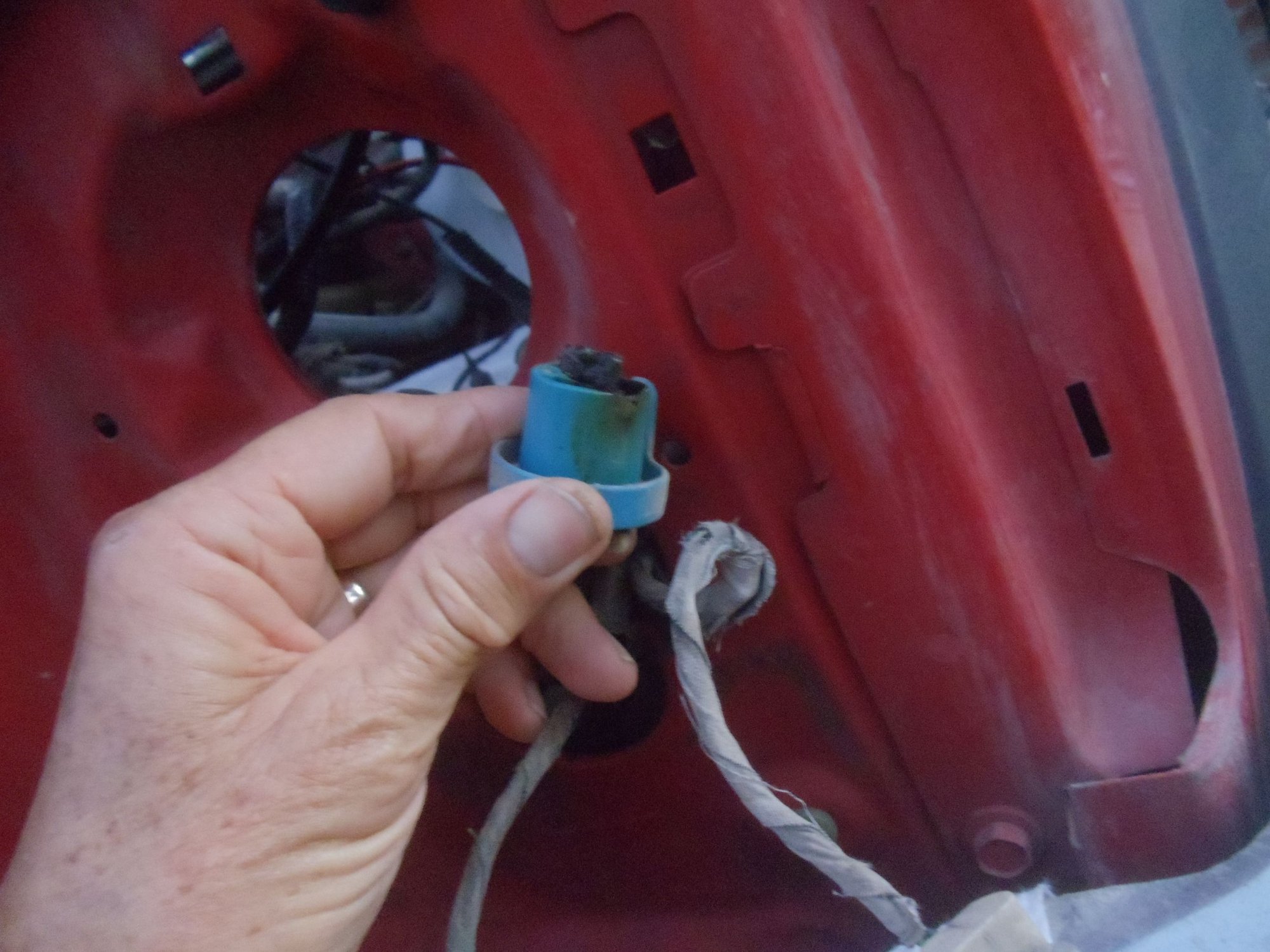

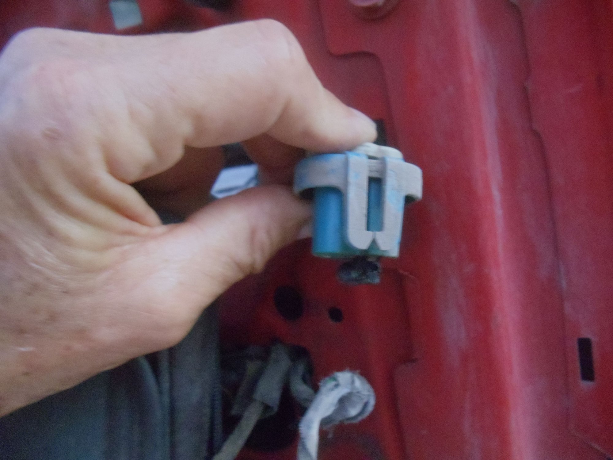

Headlamp plug-in Melted

What do you do in a case like this if you want to use the same factory bulbs? Thank you.

You buy a ceramic pigtail and solder/heat shrink the wiring.
Something like
Amazon.com: HerMia 9007 9004 HB1 HB5 High Temperature Ceramic Male Wire Harness Extension Socket Adapter Connector Wiring Cable for Headlights Fog Lights (Pack of 2): Automotive Amazon.com: HerMia 9007 9004 HB1 HB5 High Temperature Ceramic Male Wire Harness Extension Socket Adapter Connector Wiring Cable for Headlights Fog Lights (Pack of 2): Automotive
Also, I'd consider a relay harness - if that's the passenger side, you can tape it up and forget about it. If it's the driver's side, you'll still have to repair it.
I've always liked the 100W Putco harness due to the current capability of it ... taking
Amazon.com: Putco 239007HW - 9007 100W Premium Heavy Duty Headlight Harness and Relay: Automotive Amazon.com: Putco 239007HW - 9007 100W Premium Heavy Duty Headlight Harness and Relay: Automotive
and repinning like on
