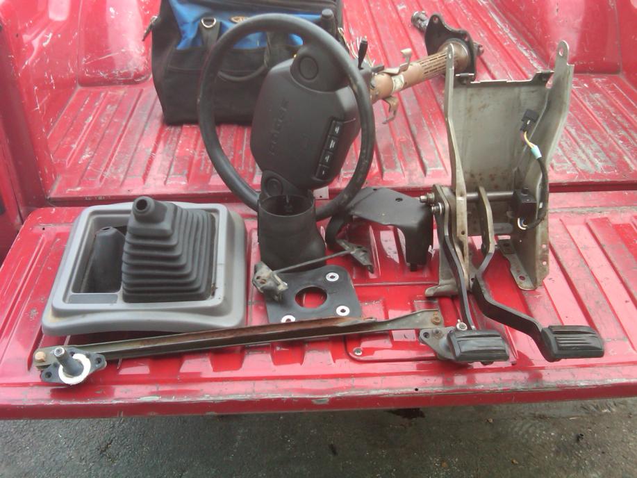

got a couple of pieces off the 94 tuesday. my buddy couldnt go with me so this is all i could get. not bad for $25 spent so far and another $200 for the complete tranny, transfer case and drive shafts from a 117k mile 94 dakota.
steering column and shaft
column covers
pedals
shifter bezel
wiper assembly, my bushings are bad and this one is perfect

Cool! You got to start somewhere.
