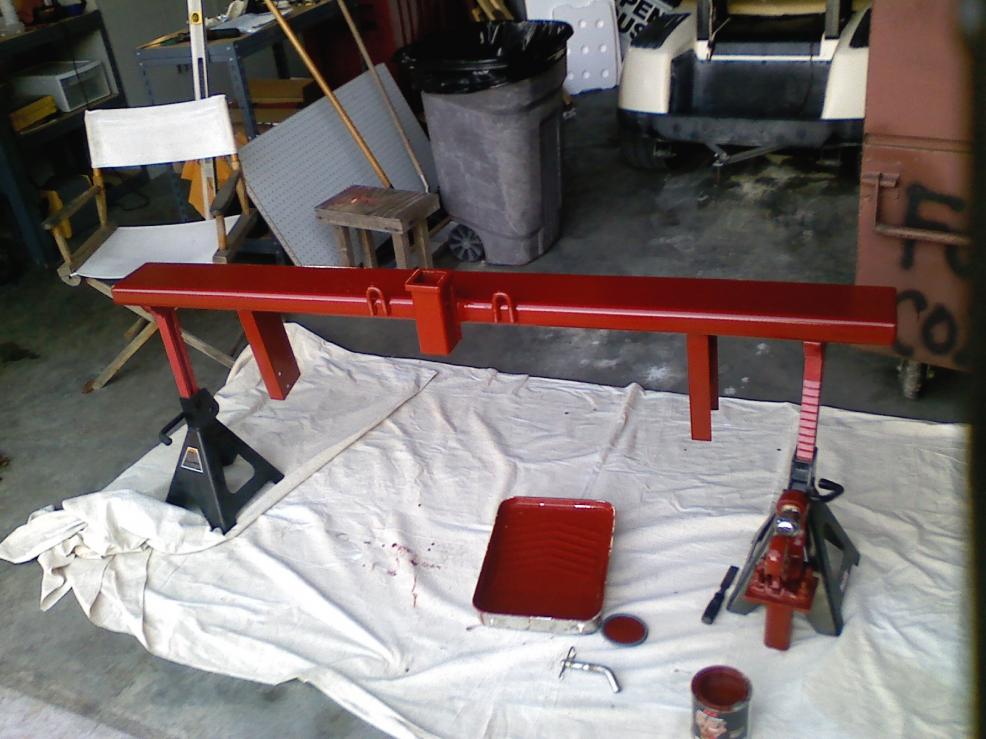

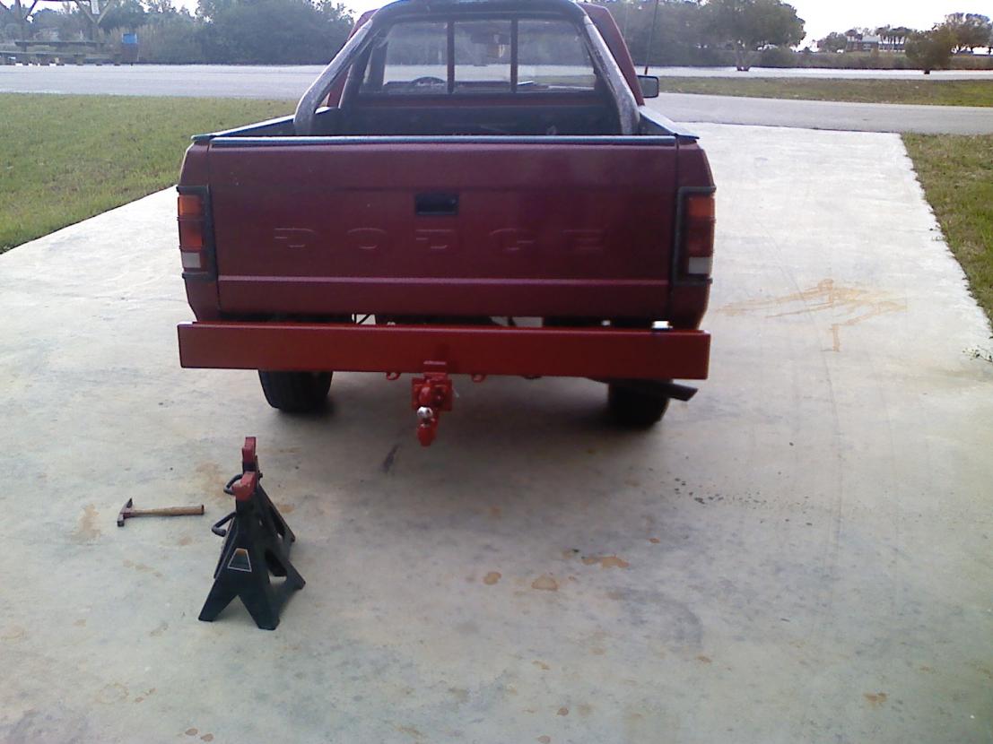

well last weak i backed into a fire hydrent and mesed up my back bumper
so i made my owen and built in a trailer hitch i used 4'' c chanel for brackets 2x6 for the bumper and 1.5'' angle iron to brace the hitch and painted it all red

very cool man, that thing looks very strong. did you fab it with sheet or is it something else?

Looks good!

i uesd 2x6 1/4 wall steel tube
