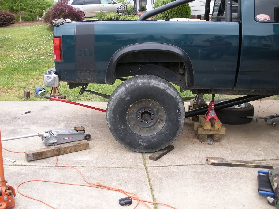

Well, this is why these write ups are always good to have to go off of... this is the part where you get to learn from my mistakes! Being as this is the first time I've ever tried to custom fabricate suspension, there were some key things that I didn't know to think about.
As posted in the last few posts, I centered the rear axle by lining everything up unsprung. I got the the spring mounts all welded up and bolted on tight and slid my jack under the axle and jacked it up to see where it would sit sprung (I jacked it up until all the weight was off the jackstands... full weight on the leaf springs). That is where the problem is! Here are some pictures... see if you spot the issue before I tell you :P
Lol, if that last one didn't give it away, then you aren't very observant! It appears as though when the leaf springs flexxed up so they were fully sprung, the center bolt moved back 1.75". I spent all that time making sure the center pin was centered in the wheel well with the spring in th wrong position!! I never really gave much thought to leaf springs staying straight and even while flexxing before! So what I'm going to have to do now is cut my hangers up and slide the mounting tabs forward and re-weld them. I also spent some time in AutoCad drawing up the spring angles and determining how to fix them best since I have to fix them anyway...
With that second design, I'll gain an inch of clearance in the wheel well while shortening the shackle at the same time, which will give me more of an angle on the leaf spring which will in-turn shorten the distance that the axle moves back and forth while flexxing. So in laymens terms... design two is much better!
But on a brighter note, I finally got to see where the truck would finally sit when its finally off jackstands again. This would be the minimum height, seeing as though I can always get more leafs to add to the pack. The front has a lot of adjustment, so I'll level the front with wherever the back ends up!
As you can see here, the truck is going to have to go up about 3 more inches above what it is sitting on jackstands to fit the tires under it, so imagine the truck 3 inches above this...
