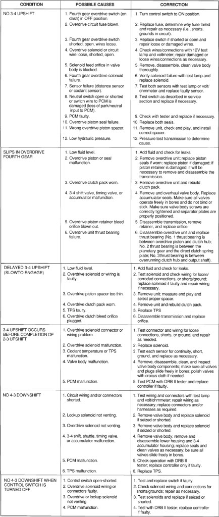

Here is the diagnosis chart from the FSM. Hopefully you'll find some useful info on it...
