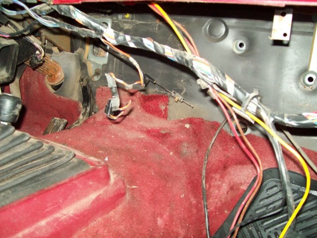

Update:
I finally got the temp where I want it. Working in the freakin snow! I replaced the water pump,radiator,radiator cap, coolant sensor,heater core and all hoses. With a digital thermometer is stays around 184 degrees. My gauge still reads just above half but that's fine by me. Now the heat will melt the glue on your shoes. Before it would barely keep you from freezing to death on the way to work. Thanks for all the help guys.
Size:  119.1 KB Name:  101_2621.jpg
Size:  115.2 KBName:  101_2624.jpg
Size:  96.2 KBName:  101_2619.jpg
