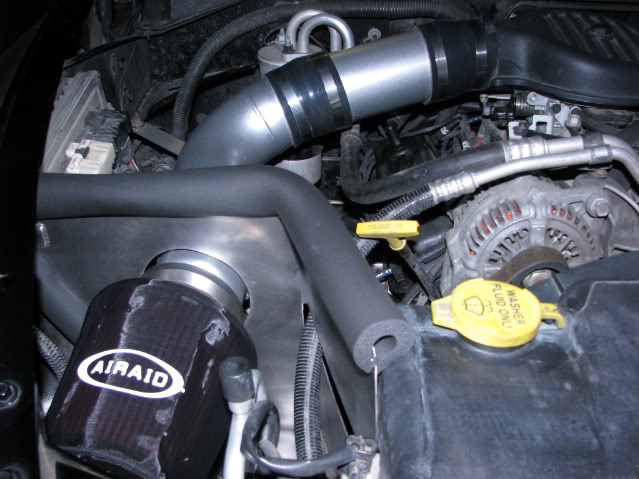

Most Magnum motors, except for 1st Gen Dakotas for some reason come with a small air hat where it is just bolted to the throttle body and the filter is down stream.
Here is a quick picture I pulled from Google. You can see that part that attaches to the throttle body is the air hat that is stock on Rams and 2nd Gen Dakotas. Then they used rubber connectors to connect PVC pipe to the air hat and then the air filter. You can grab the air hat from most junkyards or www.ebay.com or www.craigslist.org

ok, so they make air hats like this one:
but you said rams and 2nd gen dakotas come stock with something like this but do they bolt on or do i have some modifying to do?

They bolt on, just get the air hat and the S-bolt that you bolt it down with.
