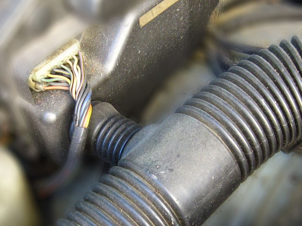

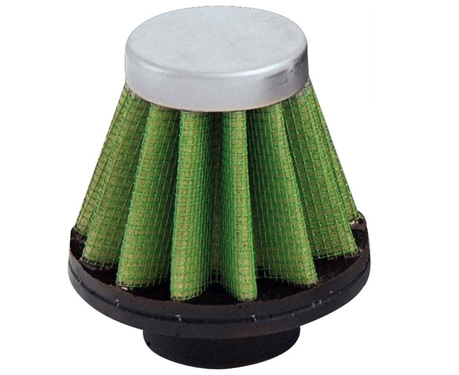

I wanted to remove the hose completely but it feeds the computer, would I be good just using a breather?

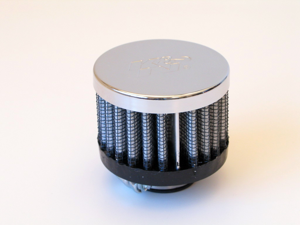

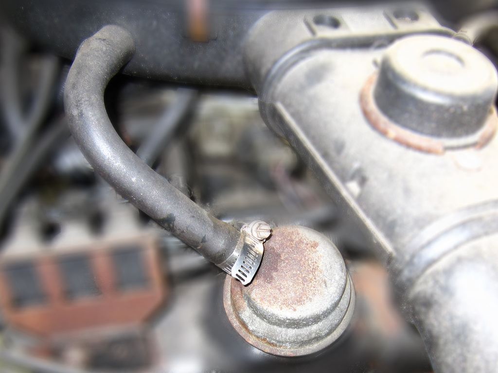

The valve cover breather seems to splash minor oil residue into the air filter housing, was thinking about unlinking them and using a regular breather?

The hose for the PCM is thought just to be a vent to keep it cool. The newer PCM's don't have the hose at all. Most people remove it.
The valve cover breather works in part with the PCV valve. They take unburned gas that pass by the piston rings and recycles it back into the engine to be burned. You can replace it with a small filter but it is best just to replace it every time it gets to dirty along with the PCV valve.
