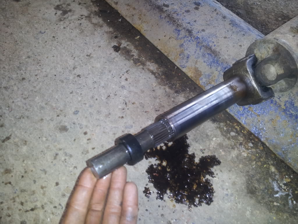

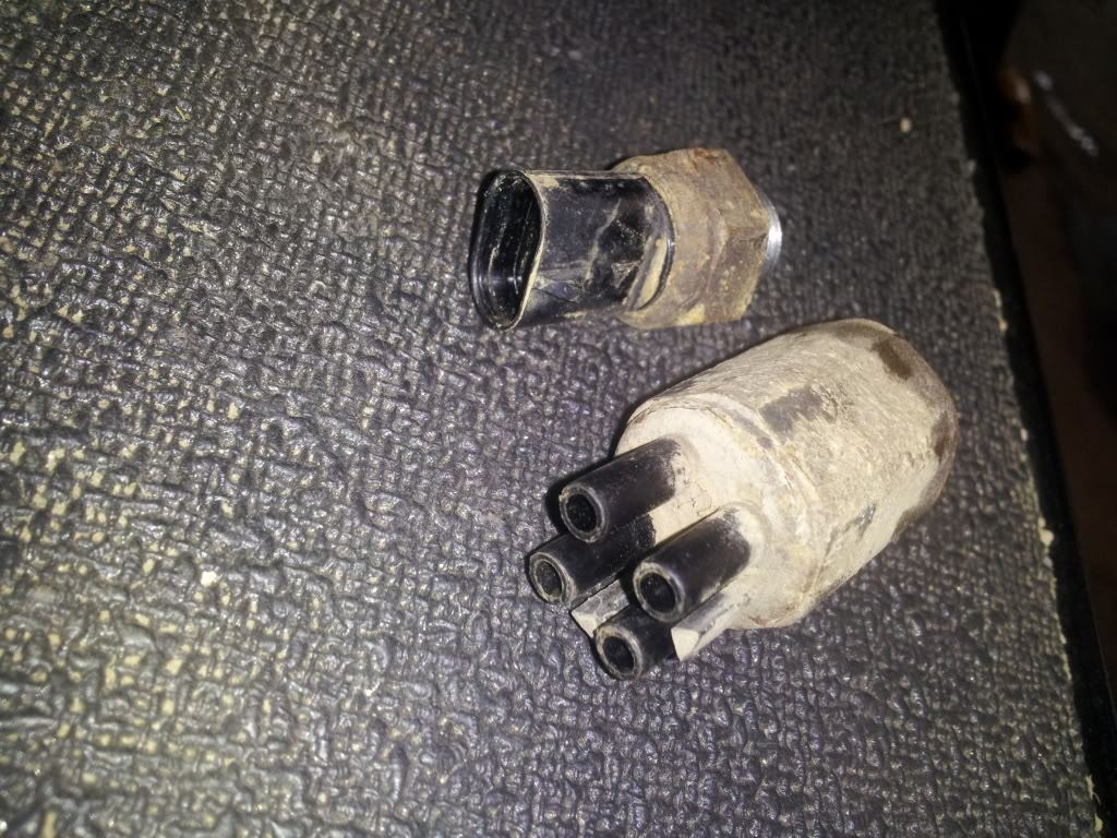

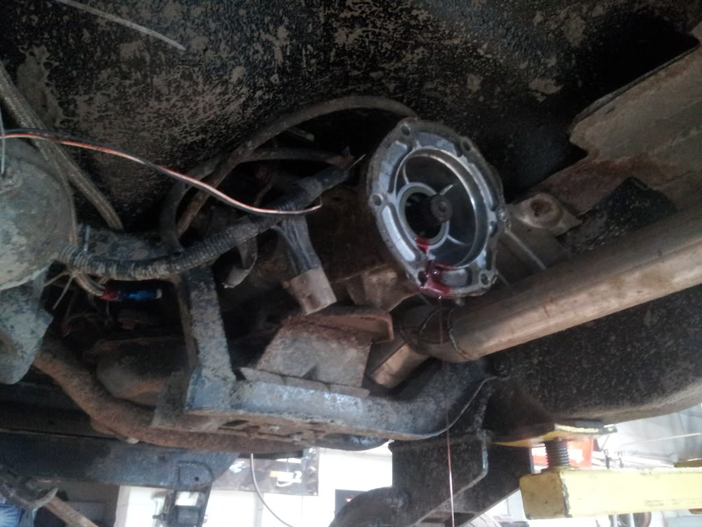

Rob, I lied again! I have some good news as long as its not to late! I just did the complete opposite of what ur goal is.. I put a 92 vacuum crap tcase into a none vacuum Dakota! They both have switches ones vacuum for front diff other is 4x4 engaged light on floor by shifter both are engaged by the SAME mechanical gear from the 4x4 shifter.. Simply swap the two the vacuum thing to that sensor that won't be used for ur truck.. I'm truly sorry if I opened up my big mouth to soon!! Hope u see this I'm time! Happy New Year!

sheared the output shaft right out of the transfer case

Were these hoses go to the tcase simply unscrew n replace to new tcase!
