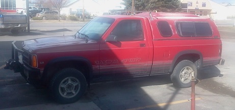

Here's what I got for $200.....
We'll see what both my boys want to do over the next year or so. Both will be driving within 2 years. Picked up a Ranger last year too, same deal..... scrap price. Runs great too. Now I have 2 sm trucks for them to start with. Figured might as well start them off dealing with their own transpo. They will be responsible for everything with them. If they do good taking care of them then I have no problem helping them and we may just drop a 5.2 in the Dakota. No skin off my butt....... if they don't, I can get my money back any day of the week from the scrap yard. They can either choose to be responsible and drive..... or walk. Cuz ain't neither one of them touching my Ford 6.0 ! Ooops, did I just say some bad words.......
