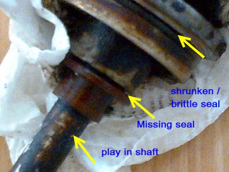

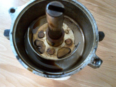

About three weeks ago I replaced the TPS. (When I took the old one off, the mechanism which turns the shaft to open and close the throttle, fell apart in my hands).
Stalling problems fixed! (so all three sensors AIS,MAP, and TPS were changed) but...truck still stumbling and hesitating while driving
- Replaced 10 year old coil.
- Replaced EGR and O2 Sensor.
- Replaced ignition wires, cap, rotor, plugs.
Hesitation gone.
- - Replaced 6 year old Optima battery with new battery.
Still stumbling.... ugh!
- Replaced distributor pickup coil plate. Found oil in the housing.
- Ordered new distributor.
Stumbling gone!
2 weeks later ....stumbling came back as expected.
- Install new distributor (84-3696 Cardone).
(pics attached).
Attached Thumbnails 1992 Dakota Low speed intermittent stalling-distributor_seals_shaft.jpg   1992 Dakota Low speed intermittent stalling-dakv6dist_housing_oil.jpg
