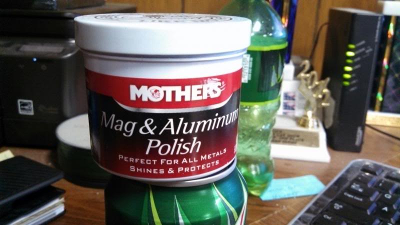

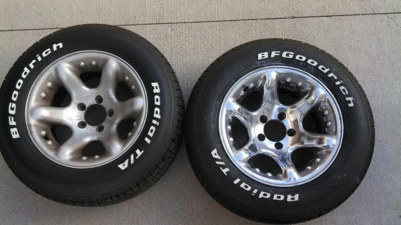

do ya have a pic of them? The wheels I have on my truck where really bad and what I did was use some fine steel wool with water and 3000 grit wet sand paper and than used mothers wheel polish by hand....post a pic if ya could just so I can see what they look like before you go and do what I did. mine turned out beatiful.....before and after:
And this is what I used:
