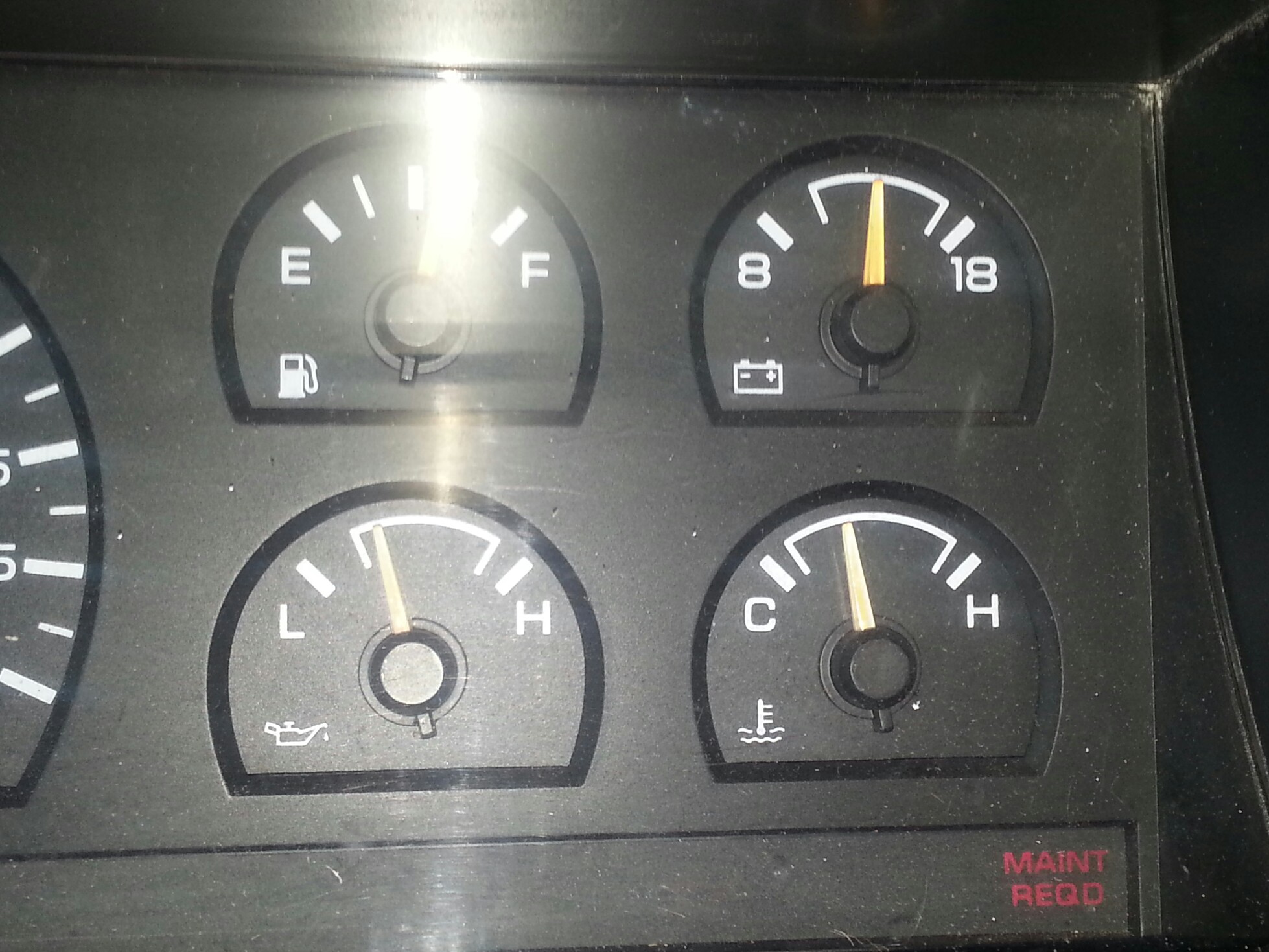

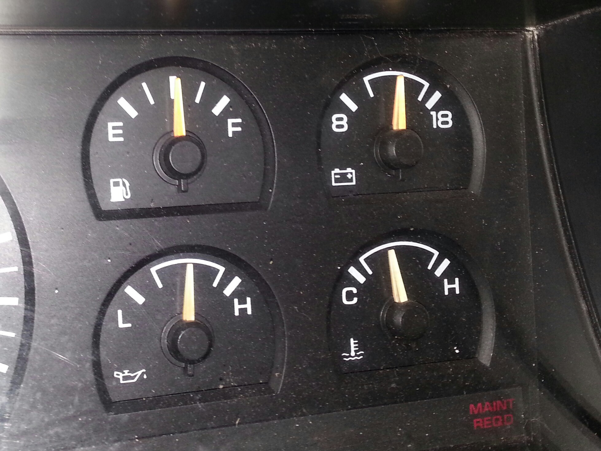

My oil pressure fluctuates high and low. I replaced the sending unit and it didn't change anything. Any ideas?

Sorry, I should have explained it better. When I start the truck it jumps to a spot and doesn't move again until I shut it off. It doesn't move at all after the initial start up.

I bet the gauge itself is sticking then.
Good news, you can replace just the gauge (pair, right and left) out of a boneyard cluster.
While the front's off, I'd be relamping that cluster due to age, but that's strictly optional.
(Two or three 8mm or 5/16" head bolts, gauge pair pulls forward, new one plugs in, replace bolts, that part's done.)
