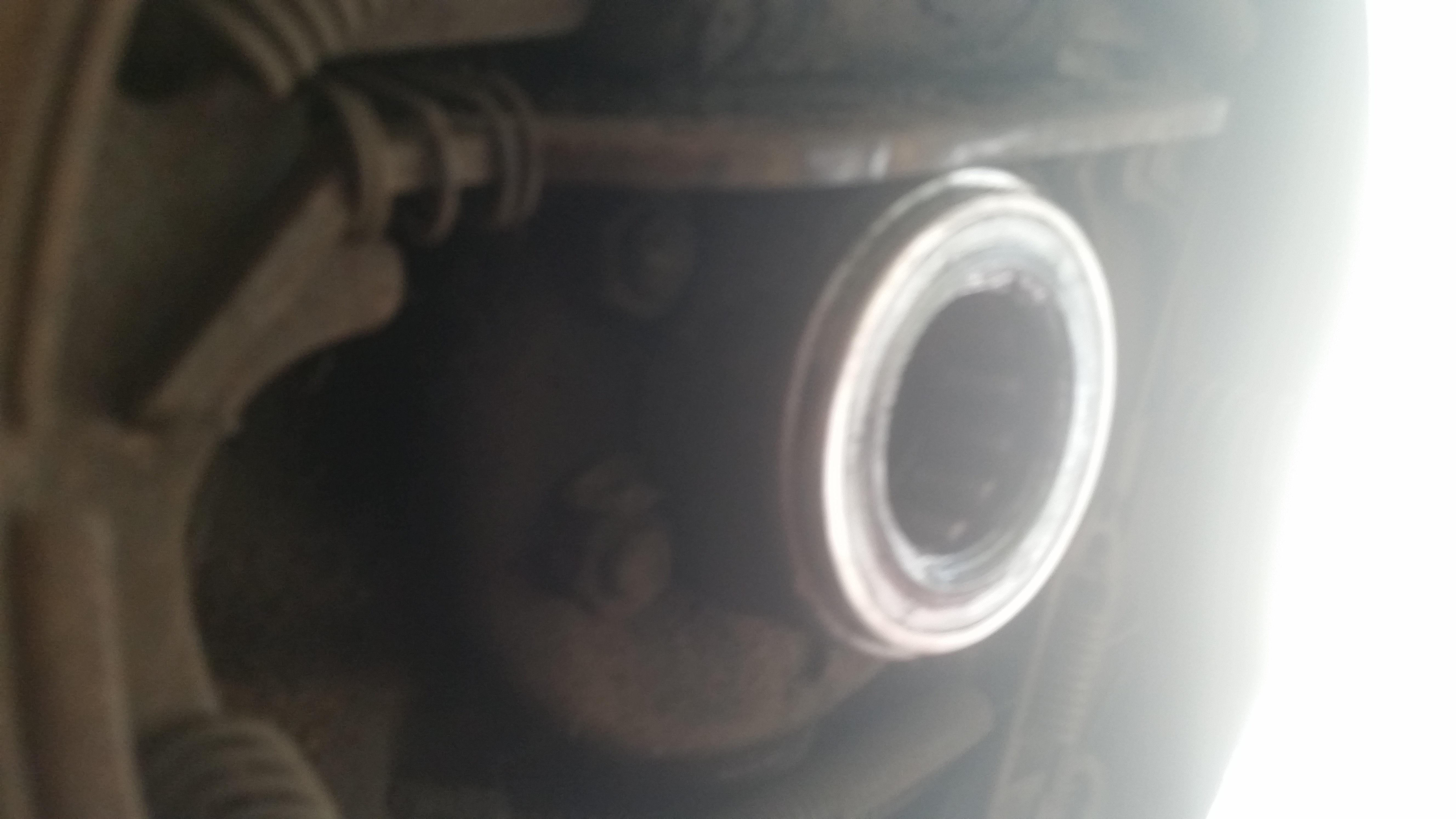

Sooo....I'm learning and screwing things up at the same time...C'est la vie, right? Point of note....there are no inside axle seals inside the differential. I thought there were seals that can be changed so I took out the differential gears. BIG MISTAKE....Now I gotta buy the tool to adjust the inside bearings. I needed 8 hands to hold the differential in, hold the bearing covers, hold the screw adjusters and screw in the bearing caps...what a pain, and I'm still not sure that those screw adjusters are seated perfectly.
Anyway, besides venting about the above, have a question on repair bearings. I think Ralph had suggested using repair bearings instead of just replacing the outer bearings and seals. So using Rock Auto I bought them. Went today to put them in, and they don't seem to go all the way in flush with the axle. Are they supposed too? Attached is the original bearing and a replacement seal to give you an idea of thickness, and the new replacement bearing/seal combo. And a picture of one I've pounded in and that's as far as it seems to want to go.
Did I get the wrong repair bearings? Am I not pounding hard enough? Help please.

They're supposed to stick out a small bit - that's the secret, they ride where no bearing or seal has ever ridden before.
And that's how you avoid buying a new axle and/or housing due to miles on an old axle.

Thanks Ralph....I read a bit and see that's the case. I also read where it's a pain in the **** to get the clips in because of that extra little bit. Fun and games.

As for the repair bearings, they do stick out a bit but in my case they didn't make it any harder to get the C-clips back in place. Also, I was surprised to see that the repair bearing had 2 seals, one on the inside and one on the outside. Knowing that the original bearings were lubricated by the gear oil, I was concerned by this because the inner seal effectively locks out the gear lube. I contacted Timken and spoke with a technician who told me that the reason for the two seals is to provide longer service life. He told me that Timken's research found that the metal from diff gear wear is a problem. Apparently there is so much metal floating around in the lube, especially on older trucks, that it shortens the life of the bearings. For this reason the repair bearings come pre-greased and are purposely sealed off from the gear lube.
