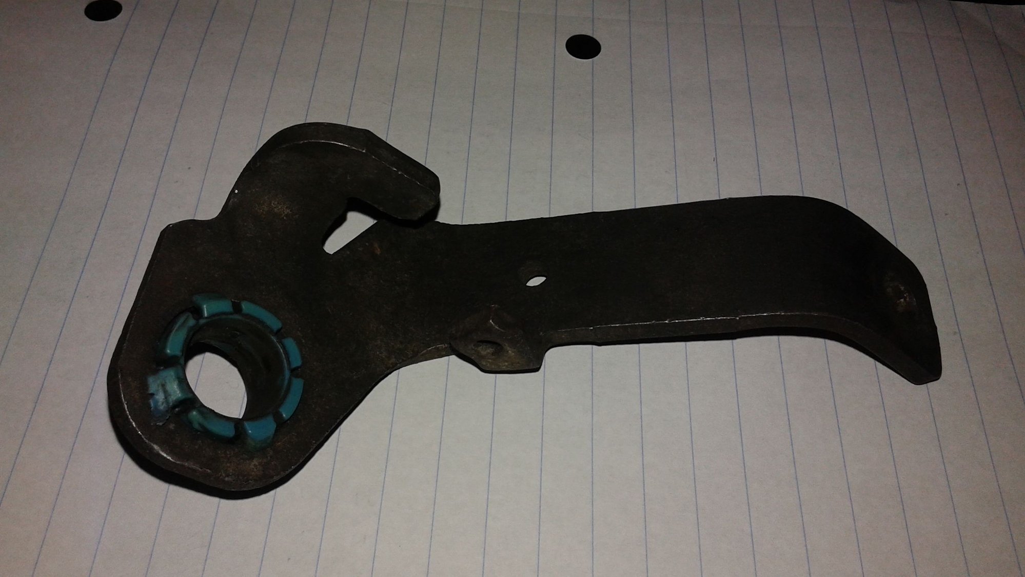

I just had my hands on one yesterday at the junk yard. I was missing the rest of the shifter linkage you see in your diagram, and was removing it from a 9x Dakota. Didn't grab that part because I have a 42RH and it's already on my transmission. Hoping to make the linkage work on my 42RH so we have the opposite problems
. In anycase, go to your local junkyard....those things are plentiful if you're willing to crawl in the mud under the truck and get drenched in grease and brake fluid while you take it off. That was my experience yesterday.
With that said, tho, the link you posted says that it's the same part for the 46RH and 42RH. The A500 listed in your link is the same as a 42RH. Are you sure it's not the same? They looked the same visually the one I was working on yesterday and mine.
. In anycase, go to your local junkyard....those things are plentiful if you're willing to crawl in the mud under the truck and get drenched in grease and brake fluid while you take it off. That was my experience yesterday.With that said, tho, the link you posted says that it's the same part for the 46RH and 42RH. The A500 listed in your link is the same as a 42RH. Are you sure it's not the same? They looked the same visually the one I was working on yesterday and mine.
