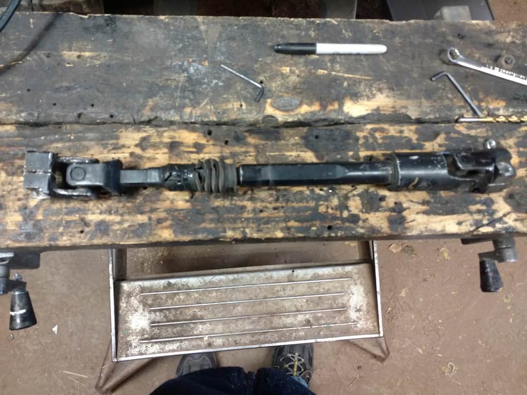

Well, I was plagued with the notorious bad U-Joints in the intermediate steering shaft. Also a few years ago the rubber in the vibration joint was completed rotted away which left crazy play one day as it failed. I had to find a suitable replacement in the junkyard. I found some replacements but there is no way to secure the new joints in the housing, also the slip shaft had too much play in between the two pieces. I compared the old shaft sizes and found the joints I needed on https://www.borgeson.com/xcart/home.php. I actually found way better prices for the pieces on ebay for $150 for all 3.

Here is the old worn shaft.
