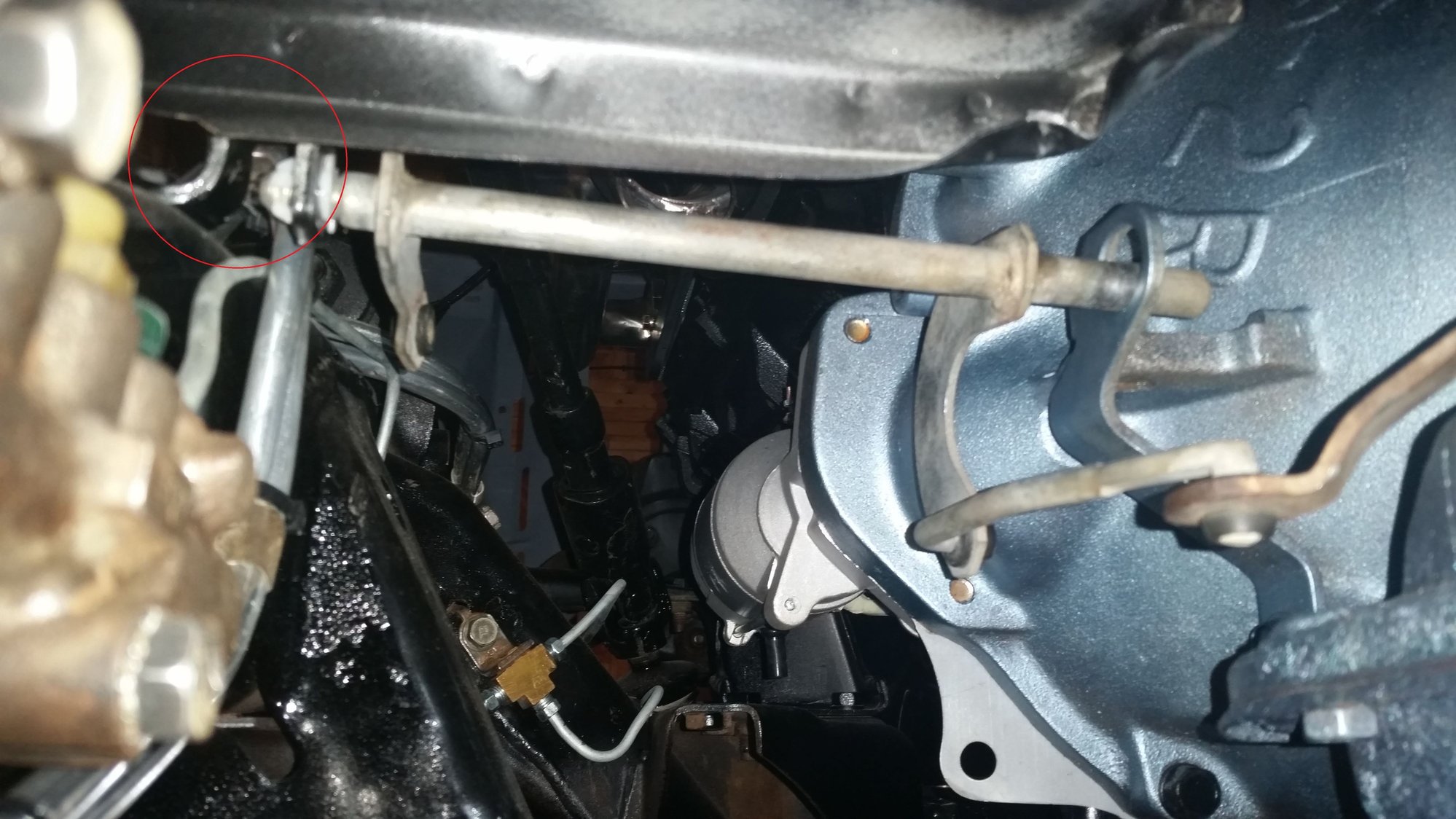

The string is simply the indicator....but would not keep the truck from going into park. That would be the linkage. You didn't say what year and whether 2wd or 4wd, but most have a linkage that's on the steering column just below the master cylinder near the firewall in the engine bay. That linkage on the steering shaft connects to a rod, that connects to another rod, that connects to the shift lever on the transmission. That linkage controls the gear, and it can become misadjusted or the bushings wear at the pivot points of the rods. Inspect that linkage, especially the horizontal rod off the frame rail...there's a bushing at both ends and often over time these deteriorate and cause shifting into gear problems.
Attached is a picture of mine...it's missing the bushing on the right at the transmission and the circle shows the bushing on the left at the frame rail.
