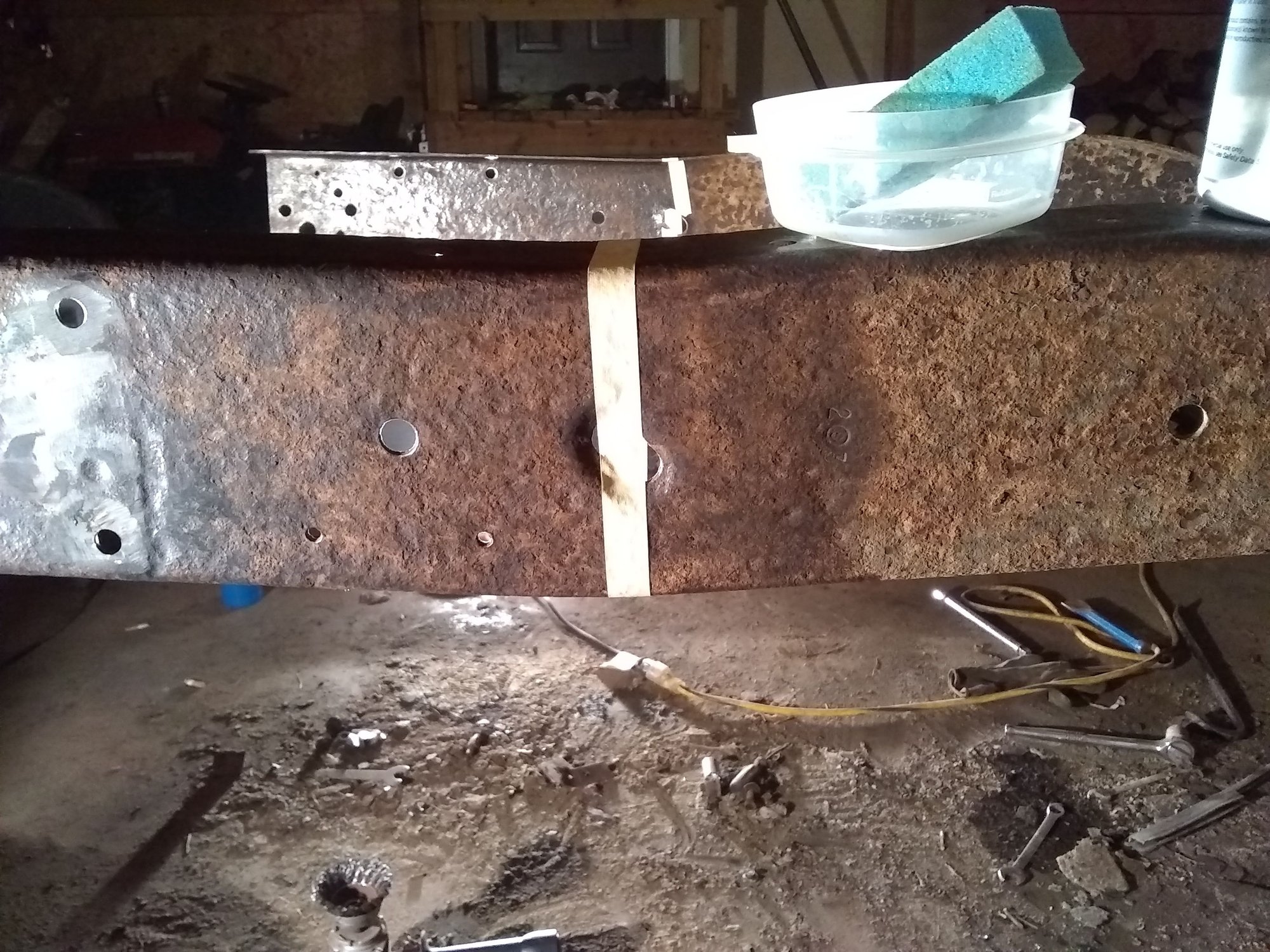

So after getting the last of the brackets off I decided to clean up a small section on both frame rails where the hitch bolts in. I cleaned it, prepped the metal to get it ready for the rust converter, then masked it off so you guys can see the before and after. I used total solutions rust converter. It's no acidic, bio-degradeable, and converts the surface to a primed and paint able surface. For all the nay sayers about rust converter out there.... It's your own fault if the product doesn't work. If you dont clean all the loose surface rust off with a grinder and wire wheel then properly clean the surface then of course it's not going to work. So please stop telling people the stuff doesn't work because you were to lazy to read instructions and do the job right. Here's some pics of the surface prepped and just after applying the rust converter. As for prep, a very hard wire wheel on my 41/2 inch grinder, degreaser, hot water, then wax n grease remover. Pretty standard stuff. Cure time on this stuff is 48 hours at 70 degrees. I put this on and it's 35 degrees in my garage but I know it'll work, use this stuff all the time. Once it's cured all you gotta do is scuff it, clean it with some warm soapy water, let it dry then paint it with whatever paint you're using. This round I'm gonna use Eastwood original satin black chassis paint.
Goes on white, starts turning purple, then will be a black primer when it's done. I didn't lay it on super thick so my coverage might not be that great. Couldn't find my paint brushes.

Here's how it looks after the rust converter has dried and cured for 24 hours.looks ok but I'm gonna throw a skim coat on it before I go out of town tomorrow just to add a little extra protection. I'll stuff those sections and get them painted when I get back on the 2nd. Need to prep my hitch as well for converter and paint.

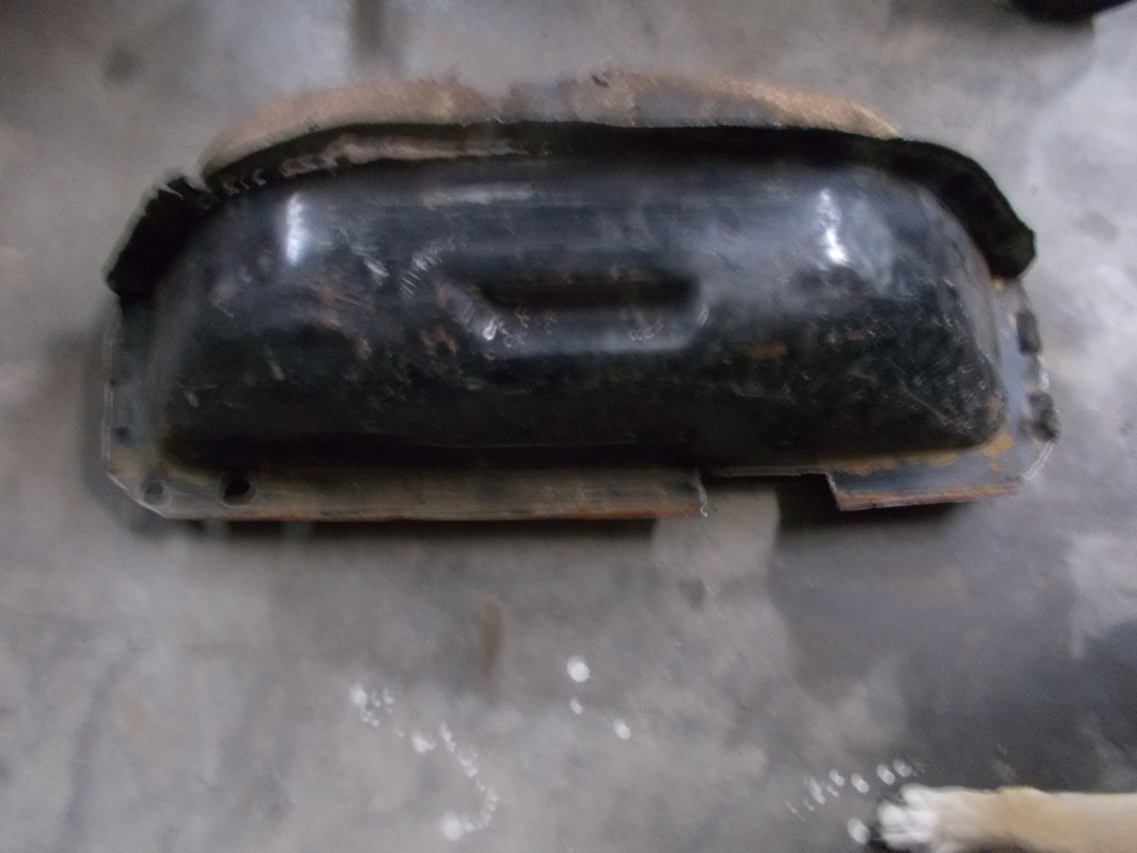

Default Pictures
Originally Posted by DAHEMIKOTA
I would need $20.00 each plus shipping. I am in middle Tennessee . Maybe could be shipped FedEx. Dan

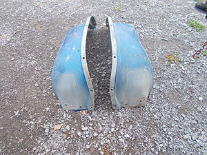

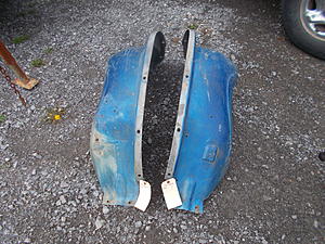

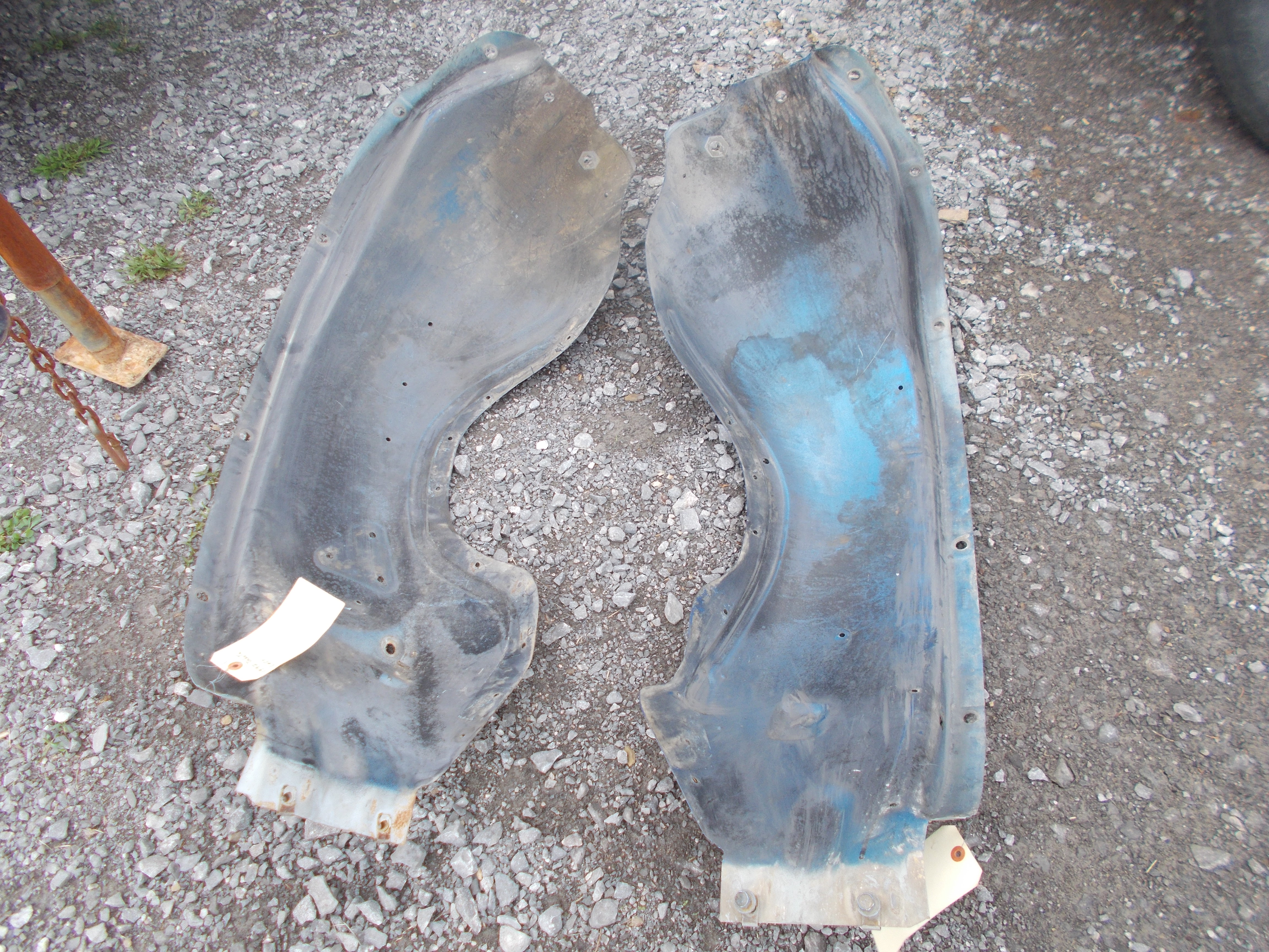

Here are some pics of the inner fenders.

These were taken apart to check for any rust between the inner and outer fender. They would be painted before they are assembled back together. Dan
