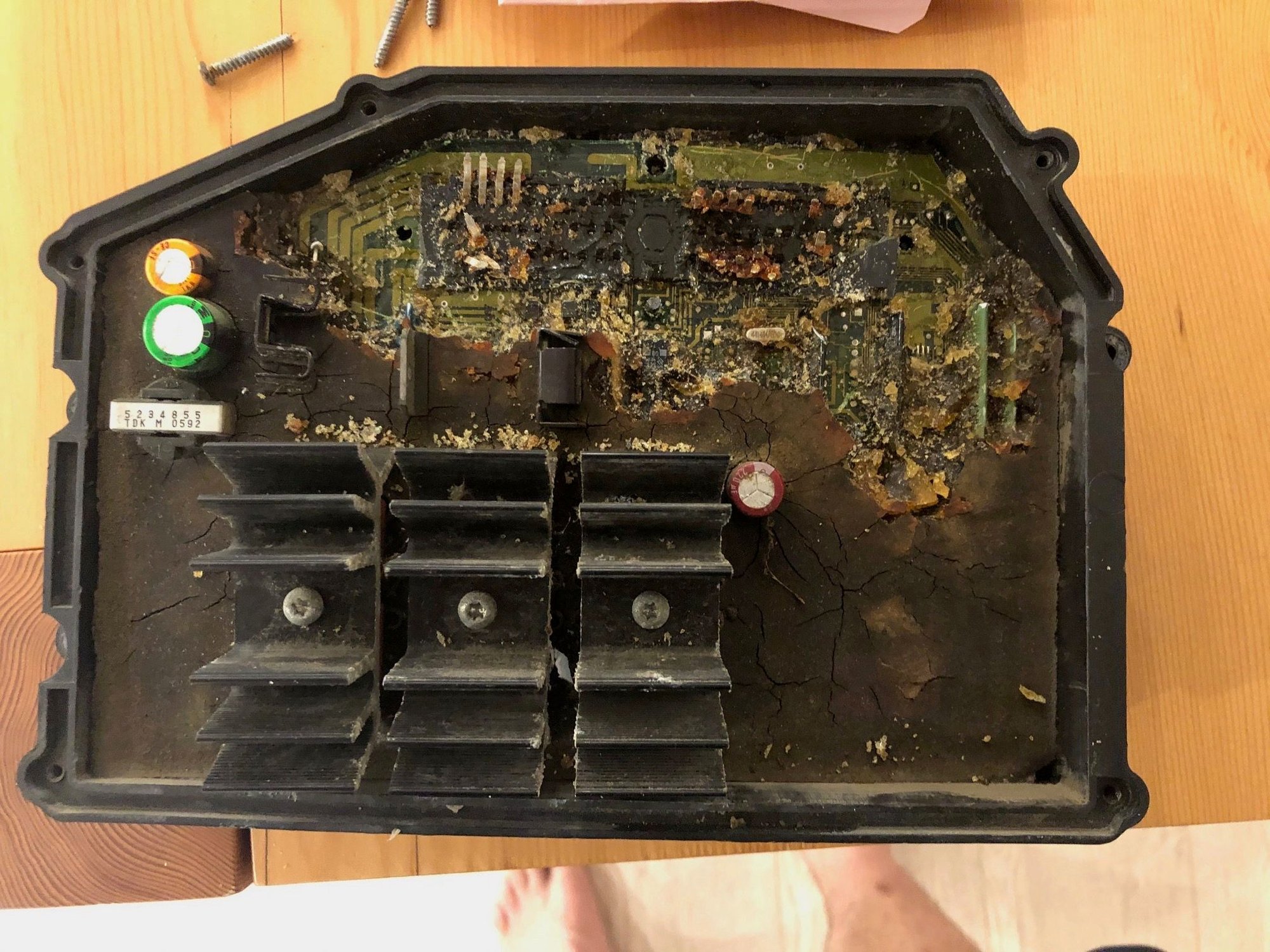

The thing I noticed about those PCMs is they are filled with potting compound - some sort of thick dark orange epoxy-like substance to shield it from the elements. You need to remove this before you can access the components on the board. I wanted to take the ECM plug to make a harness, but I damaged a whole bunch of components on the board and the plug itself by doing so. You need to use a lot of force to pry it off but it is easy to scratch or get your screwdriver under a capacitor or chip and inadvertently pry it off.
This could be why many shops don't want to touch it.
I'm attaching a photo of the ECM with the plug removed and the potting compound around it to give you some idea.

Just one of many reasons why I didn't mess with it.
