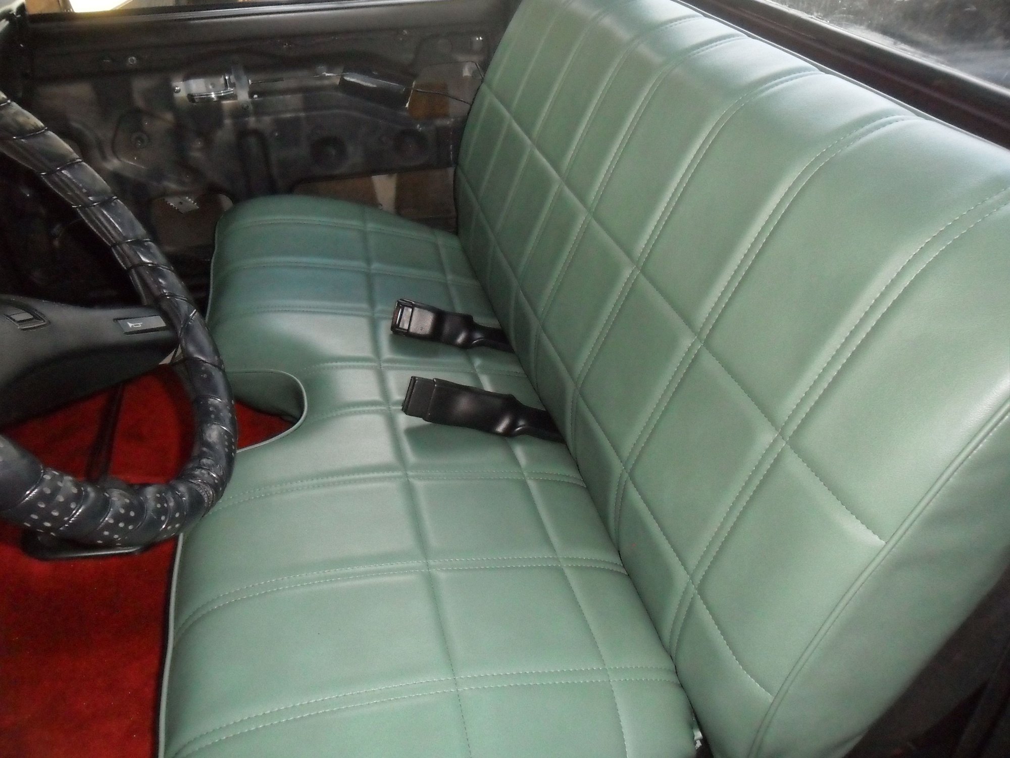

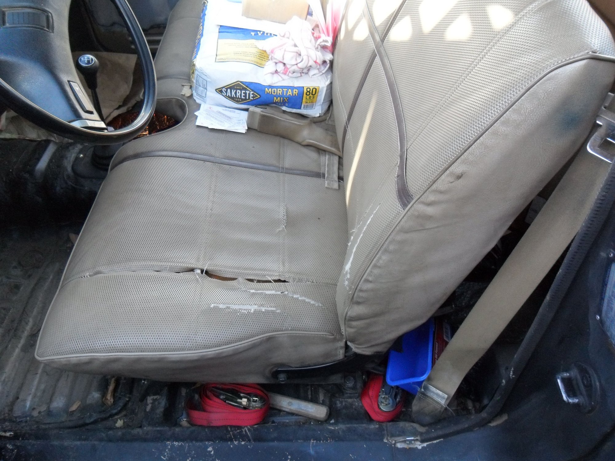

I recovered my old D50 bench seat and its like new. I just went to the upholstery supply and they hooked me up with foam, Turns out I only needed to add 1" foam and I bought a new skin from this outfit. https://seatzmfg.com/ Here are a before and after pics I also got some vinyl and redid the headliner and door cards. $160 delivered for the bench seat cover. I thought it was small at first but I put it out in the sun and did the work there after it warmed up and you can see how nice it looks. They also send a cheap hog ringer and hog rings with the new cover. I had already bought them.
Edit- they wanted $500 to do it at a shop and $600 to spray the bed. I paid about $50 for the foam. And I redid the bed rust issues, sprayed it with Raptor bought a compressor big enough to do it and got carpet for the interior for <$800. Sometimes it pays to try something you never did before.
Before
After
