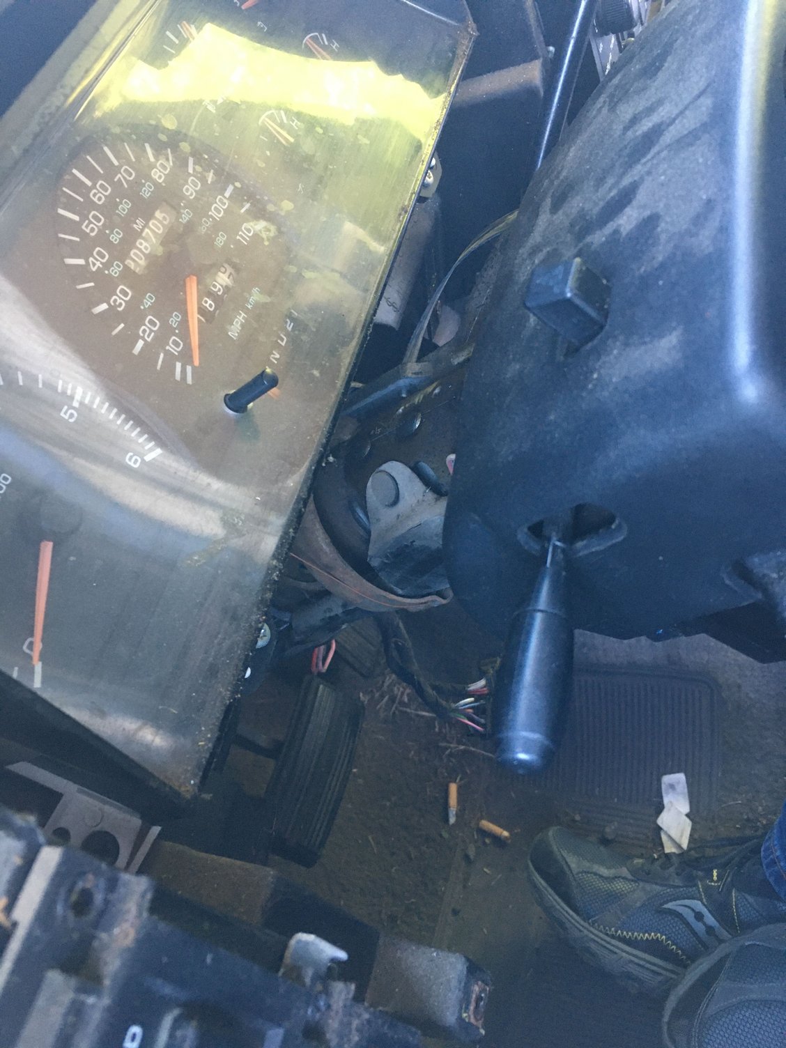

So turned on the lights today and ever conceivable bulb on the dash lit up and EVERY gauge maxed out for about 5 seconds and then reset and lit up like normal. Hadn’t fired it up yet. Only pulled the **** half way out. No fuses blown. Guessing the switch is bad.. hah ?

Again, I'd check that ground inside the dash; the light switch isn't connected to the gauges, but if the ground is floating, that electricity has to go SOMEWHERE when you turn the lights on, so it may return through the gauges.

Now the tach is reading lower than it should 250rpm at idle.. yeah right.. I’d hear, let alone feel that change. thinking not just the light switch so much any more.
side note
taking off the top shroud around the ignition switch seems like some wizardry.. there has to be a way to get it off I mean they put it on... but how?? The height adjuster on the steering wheel looks like it screws on but it’s much looser as in it jiggles and jaggles as opposed to unscrews... needless to say I stopped messing with it. It might slide off if the hazard light switch wasn’t there. Couldn’t find anything in the manual.
