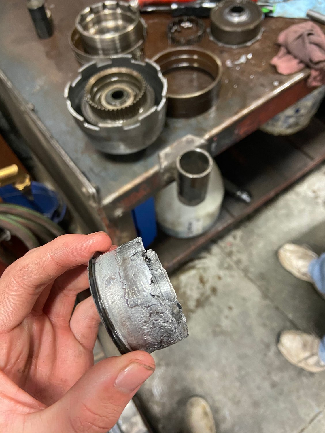

The transmission would start to slip once it got up to temp. I actually bought a rebuild kit and had it almost all the way done and went to do the rear servo and found the bushing on the very end was really screwed up. (See the photo) there was metal shavings all over the bottom of the pan and I was really confused (until I saw the bushing)
My cousin had it before me and was hauling hay in the back and as you know these are really meant for that haha. I tried to revive the trans with some seafoam and a fluid flush and it worked for about 6 months.

That bushing should be available. I'd finish the rebuild.
