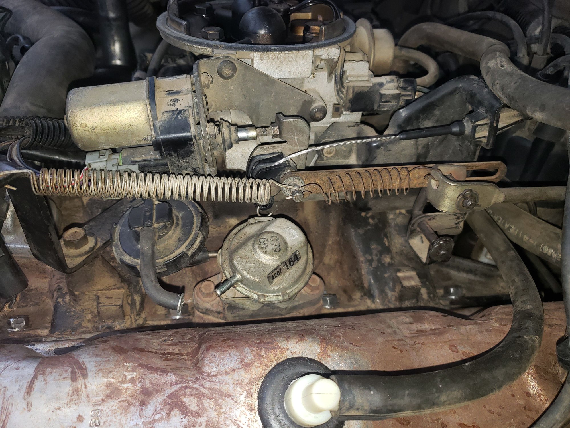

I've quadruple checked all my vacuum lines, to no avail. And my throttle return spring I never removed when I took the throttle linkage apart to remove the intake manifold. It still feels strong though. I'll post a picture of my set up.
I've read some places that the ISC Actuator can get really dirty inside and need cleaned and greased, but it doesnt always stay pushed out, it's just sometimes, never on start only after I've driven for a bit, and I can always give my pedal a kick and it will stop...
No I haven't gone through the adjustments procedure, for a couple reasons I suppose... I never adjusted the screw when I took the linkage apart, I was careful not too, and it idles perfectly fine when it's not acting up... should I readjust it just incase?
Do you need/want a picture of the actual throttle return spring? I realize now that's just the kickdown linkage springs
Thanks again
Throttle/kickdown linkage side view
Throttle/kickdown linkage top view
