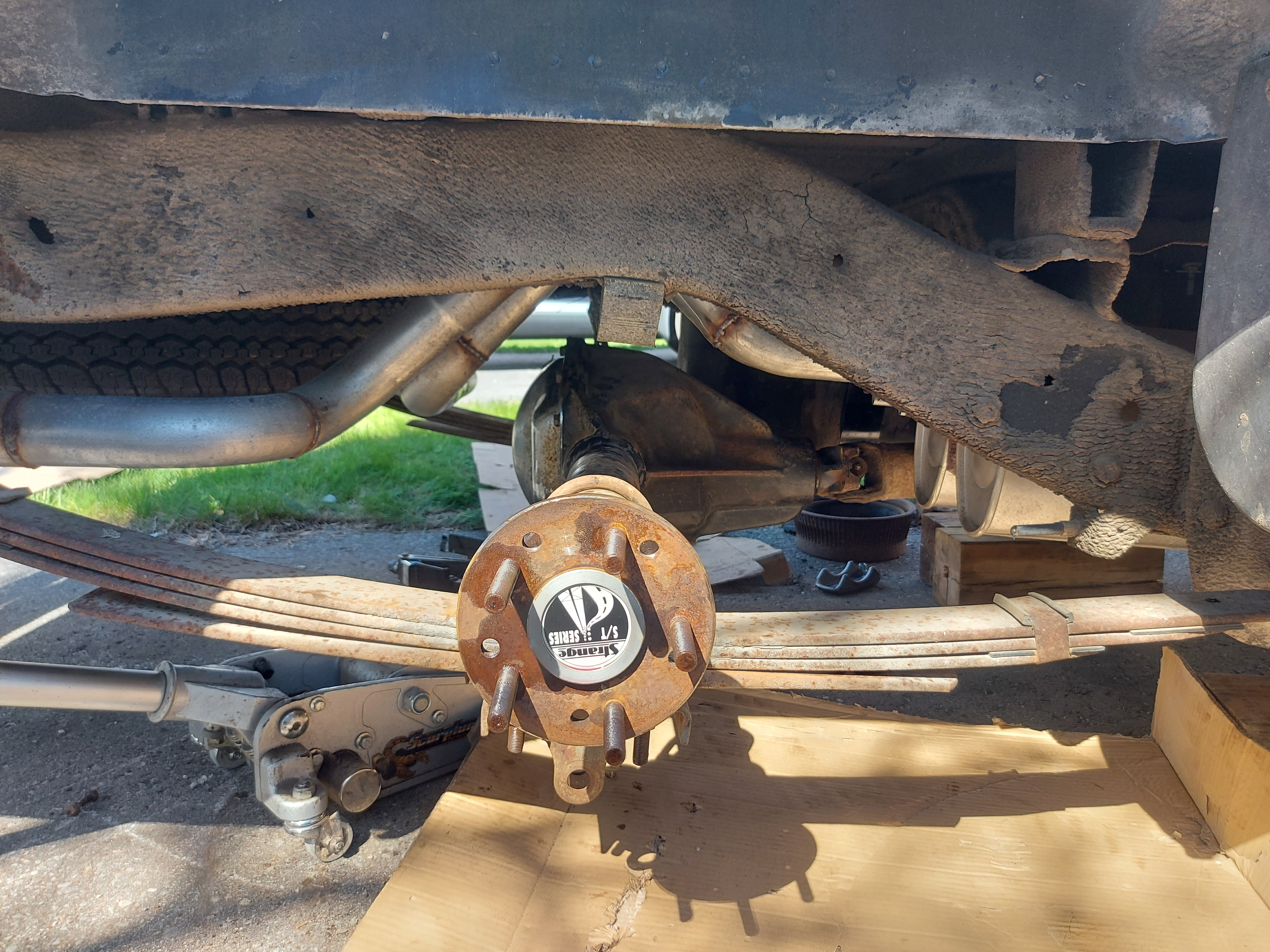

Pic of the Dana 60, need to weld on new perch mounts after setting pinion angle.
