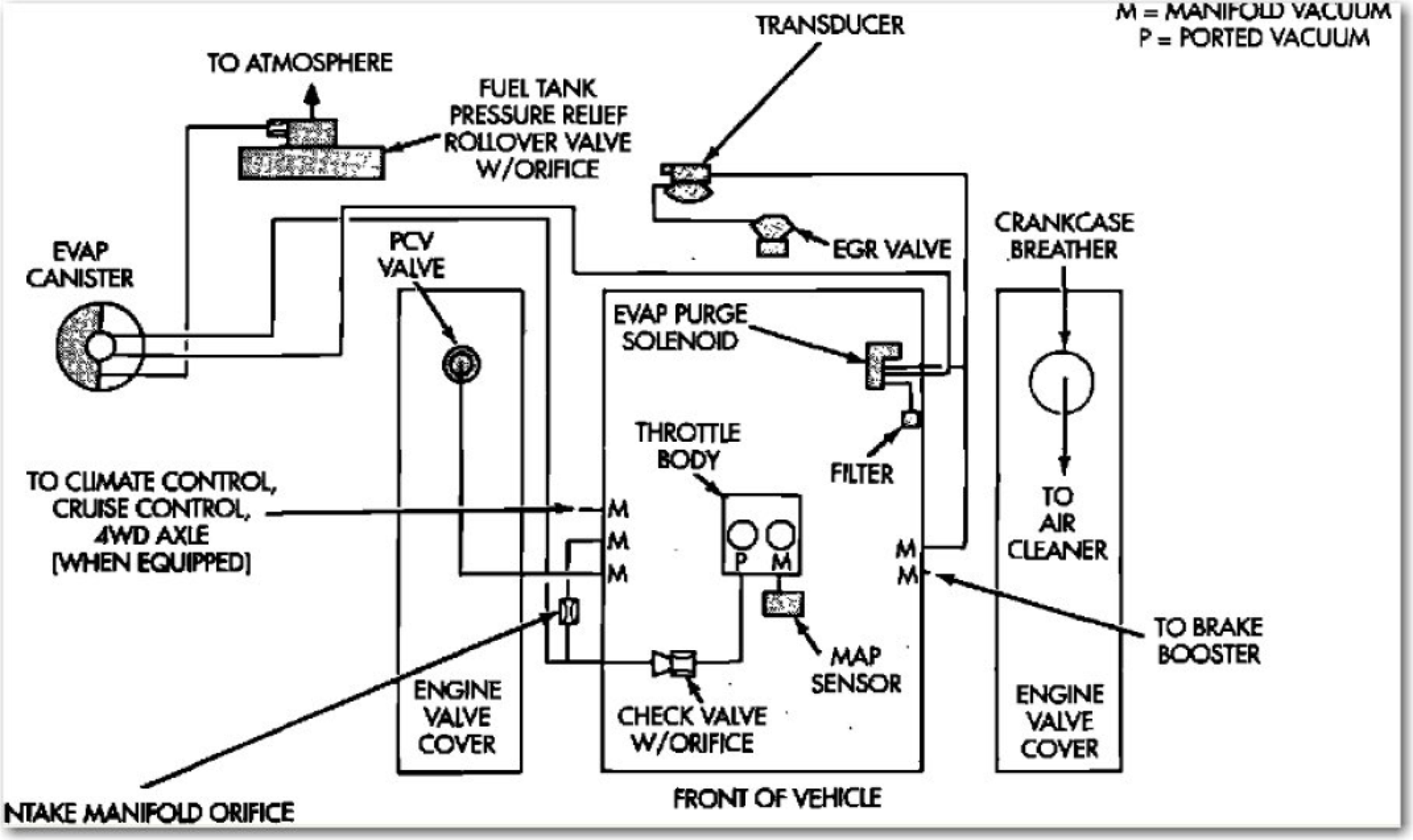

I bought a 6 book set repair manual for my 1992 Dakota with the 3.9l, there are no diagrams for the vacuum lines any suggestions I have at least 5 melted nylon lines some of them are for the front axle lock for 4x4

6 books? Try Bishko the original publisher for the factory service manual http://www.autobooksbishko.com/repair-manual.html You can get a CD cheapest. Here is a diagram I got online for my 94.

Thank you for the link the manual they show is the one I have in my set has all the wiring but no vacuum

Yours doesn't have the emissions section?
That diagram there is from page 25-3 in the 1994 manual from Bishko.
