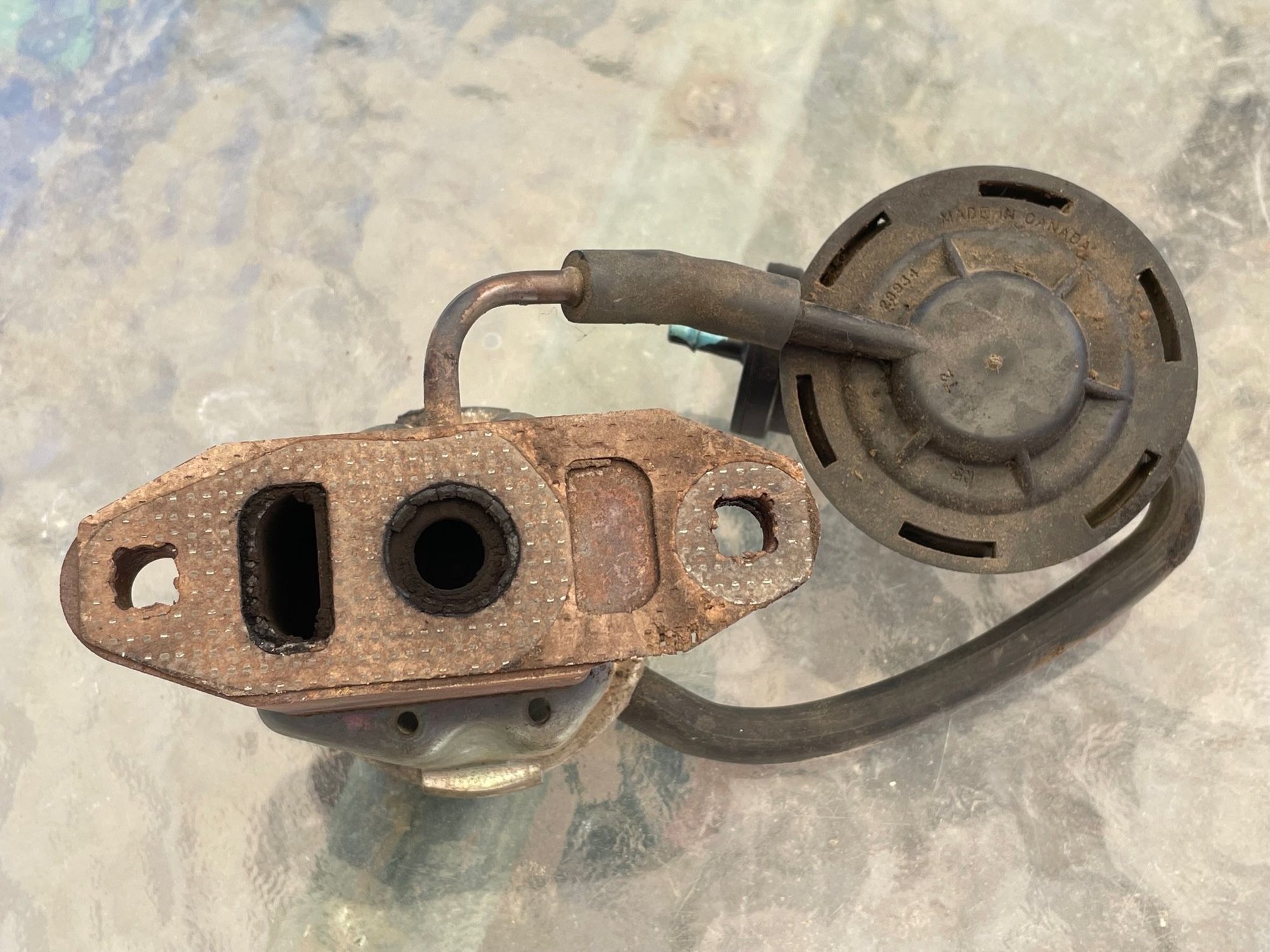

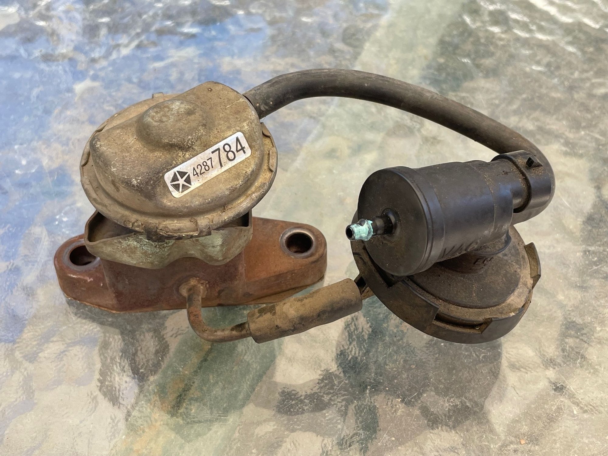

No thanks to the two mechanics I took the truck to! The first mechanic said it was probably a loose wire somewhere and 2nd mechanic said the vacuum lines were okay and it was a bad computer. I went on eBay and got another computer for the truck and put it in and the same problem. Then I was like whatever I will just brute force the problem and keep buying every part till I fix it! I already put about 5 new parts on the truck but first I order new fuel injectors and put them on the truck same problem, then I bought an intake air temp sensor, no change, and then I bought an EGR valve, and boom! it fixed the truck!
Old broke part
