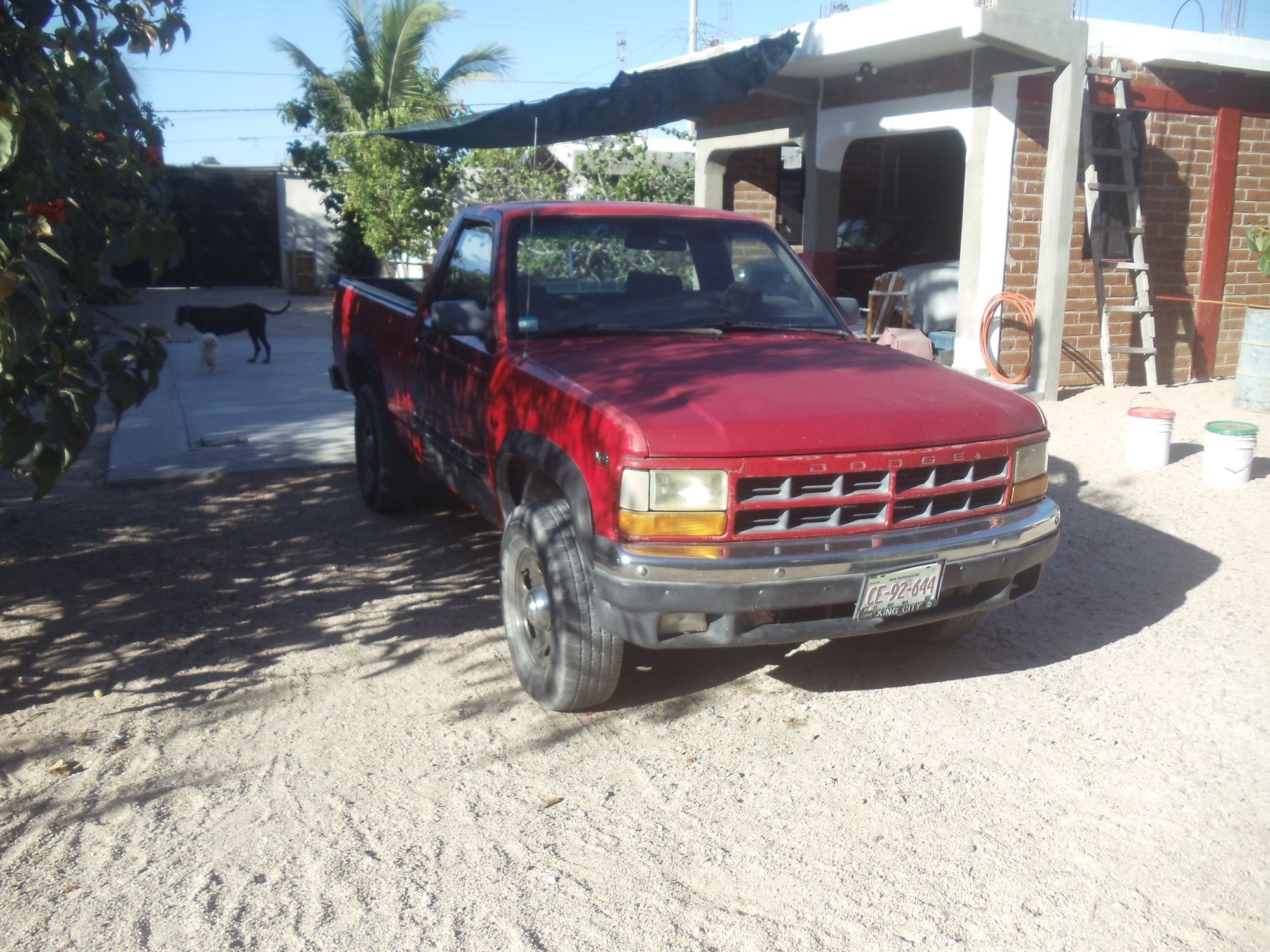

I don't need a heater in Baja California, Mexico, but I still wonder why the heater in our '96 Dakota Sport 3.9L 4X4 blows cool air. I am refilling the cooling system after a flush and it is recommended to run the heater during the process. I don't see any under-hood valve that manages the heater intake hose (hot side) like many vehicles have, so I don't know what the problem is. I only see both heater hoses entering the firewall on the driver's side.
I did notice the dash lever to adjust heat from cool to hot was very stiff, but the lever still moved all the way to the right. Thanks for any input.
