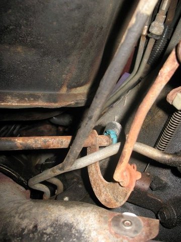

Photos of auto trans shift linkage. 1st photo without bushing 2nd with. Check that the bushing exists and ISN'T cracked or broken. There's also a blueish fitting on the same shaft toward the transmission. Make sure that's intact. Driver's side, perpendicular to tranny. If that all looks OK then Hey You's neutral safety switch suggestion remains valid.

Check photos above your last post in case you missed it.
