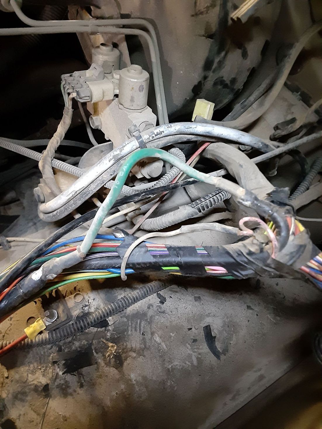

I unwrapped the wiring bundle under the washer bottle after reading about wire splice issues. It looks pretty good to me. What do you guys think?

Well I got back to trying to diagnose the no start condition. After posting the pic on my first post I realized that wasn't the splice everyone talks about. It is actually a 3 into 1 wire splice closer to the power distribution box.
I found it and it looked green so I figured there was some corrosion. Cut out the splice, stripped back to clean wire on both ends and connected the ends with some extra wire. Tested continuity thru my repair and it was good....still no start.
