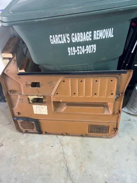

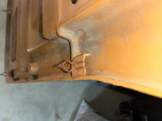

2. Remove the inner door panel. They are held on with 9 metal scissor clips that go in a hole (see pic below). You get a pry bar next to the clip and pry the panel away. Do all 9 clips (see pic below). Feed the power lock module through the hole and put panel aside.

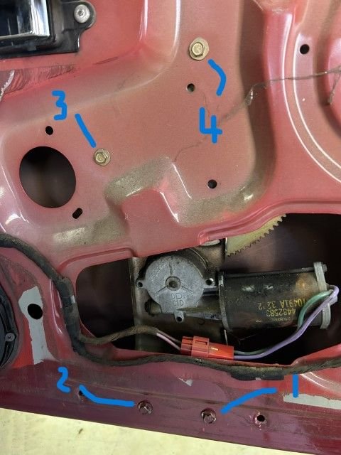

3. Here's where it starts to get fun. You'll have to cut the plastic sheeting as needed to access the parts inside. Don't try to peel if off. Just cut where needed and use clear packing tape to repair later. [UPDATE in BOLD: I learned this after doing the passenger side: Raise window. You can remove the three lowest bolts from the power window assy and slightly loosen the top-most bolt (#4 in pic below) but don't remove. This spares you from having to remove the entire power window assy from the door. Go to the next step]

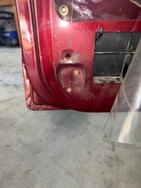

4. Now look at the lower left side of the door (see pic below). You will see two 5/16" screws. Remove them. Those screws hold on an odd shaped plastic block on the interior that acts as a vertical track bumper to keep the window from sinking down past its limit. Remove the odd shaped block. Carefully lower the window to the bottom. [UPDATE from above...the window and power window assy should "tilt/rotate" on the single loosened bolt. This allows you to get the window out of the way of the five screws that secure the beltline.]

Close up of the clips that hold the inner panel to the door
4 clips along the bottom, 3 toward the back, 2 toward the front.
Middle of the pic shows the two screws that hold on the oddly shaped plastic window bumper for the vertical track.
The four bolts securing the power window assy. Remove 1 thru 3. Loosen #4.

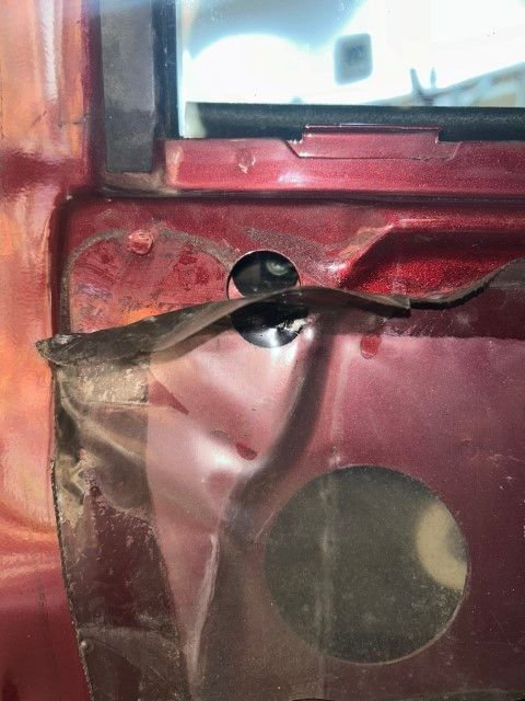

Access holes for the five screws that secure the beltline. There are five of them that run across the top.
