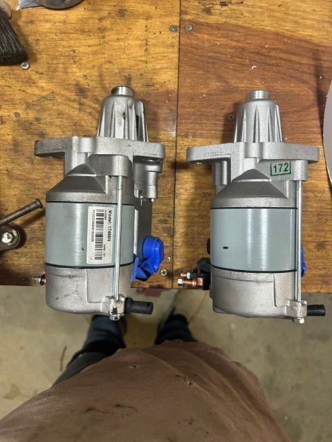

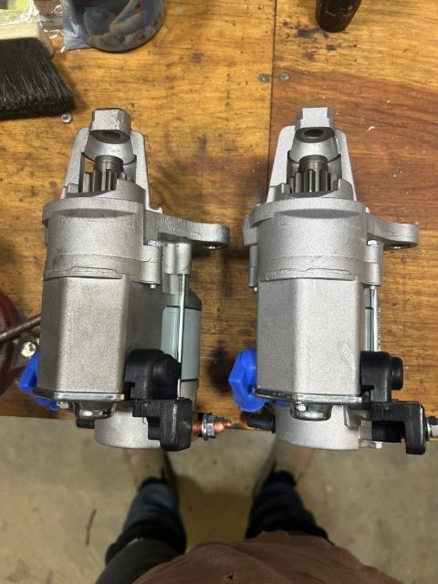

The new Remy starter showed up. Pulled the new DENSO and put in the Remy. All appears to be well. So either the DENSO was a lemon or I didn't install it correctly (I never underestimate my ability to screw up the installation...ESPECIALLY now that I'm getting up there in the years).
Here's the deal. I put the DENSO starter and Remy starter next to each other on my workbench. There isn't a pubic hair's difference between the two. In fact, the paperwork inside the Remy box used the DENSO part number. It's a DENSO starter that Remy rebadged. I'm kind of guessing DENSO is the only company that makes this specific starter and any other brand is nothing more than a rebadge. I believe this starter is used on some GM and/or Ford models in addition to Mopar.
And finally, my truck has started the first time ever since I swapped starters. Prior to that, more often than not (lately), it was taking multiple attempts to start the truck. So hopefully I fixed the problem I set out to fix.
Thanks HY for your guidance, once again. As usual, you provide solid advice. I'm glad I put in another new starter.
In each photo below, the DENSO is on the left. The Remy is on the right.
I can see some definite differences in the castings. They have to be similar because they are both going into a specific spot and the design of where they go defines how they are shaped.
On firing orders, on my own vehicles, I will use a white paint pen and write the order on the bottom of the hood. Years of miswiring gets you into that habit.
The DENSO part number was printed on the Remy starter paperwork that was in the box. That kind of blew their cover.
