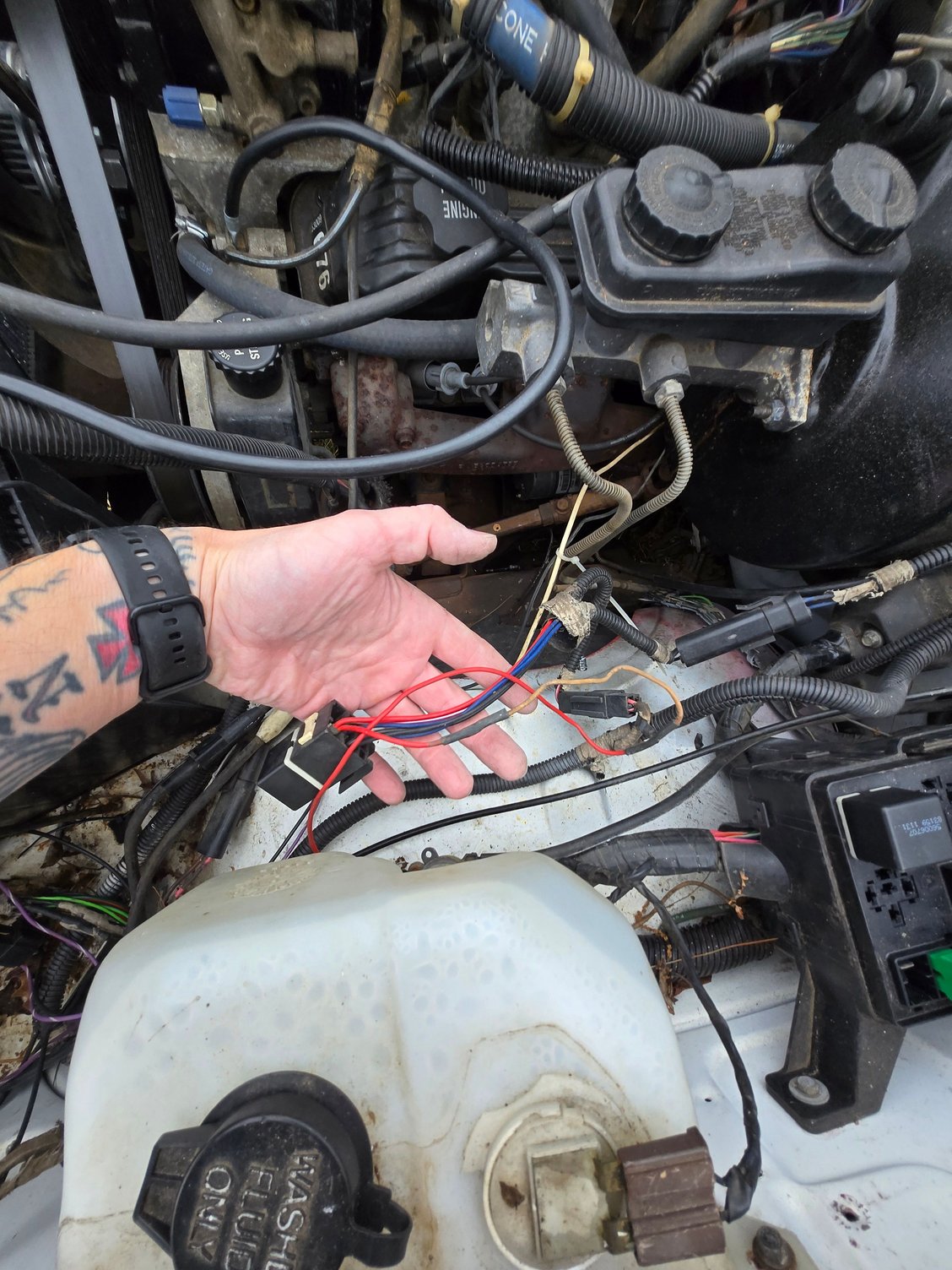

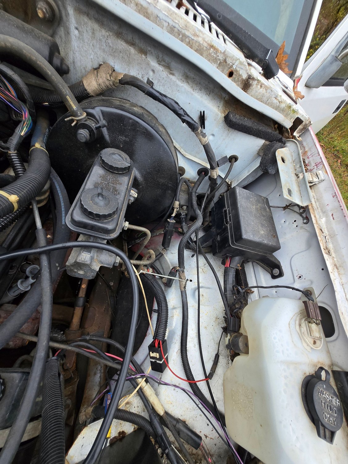

Hi guys, just got a 92 Dakota with 60k miles and it's doing the thing where it seems to run fine, but just dies after a few minutes. No check engine light, just the oil light comes on, and its not running long enough to overheat. I have the fuel injected 3.9, non magnum I believe. I keep reading that there is a 3 wire power splice, under the fuse box, that gets corroded and needs to be cleaned to fix this issue, but I cant figure out where it is. I attached some pics that I took while fruitlessly searching the harnesses near the fuse box. Could someone tell me which I am looking for?

Your washer fluid and fuse box is reversed on my 94 magnum. As I understand it the splice 3 into 1 is below and forward of my fuse box. That would make it a bit forward of the wheel well on mine. I would chase out the harness that passes under your fuse/relay box and look at it forward of the fuse/relay box. You might need to move the washer fluid to get at it.
I have been lucky and never had to deal with it. If you want to use friction tape (that is what that cloth stuff is) instead of electrical tape Ace Hardware has it.
